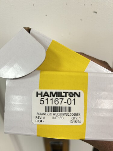

If you could specify your platform and the Cognex setup, that would be helpful as well. We have several Cognex options so I’d like to confirm - a picture would likely suffice!

Hi! We have a Macro that is imported to our Hamilton Star that includes barcodes that cognex is scanning to ensure the right tubes with these barcodes have been loaded. On this list barcodes might appear twice because we need to use a tube twice. For example we might have 3 barcodes on the list but only have 2 tubes loaded. We are not sure how to get the congnex to scan a tube twice so it matches up.
I do not think scanning the barcode twice in this situation is necessary. If you scan it once, you know the barcode and position for what was physically loaded onto the system. These values can be placed into an array. When you import the list of what to test, it could have multiple entries to transfer from the same barcoded sample(s). You can reference the array to confirm the tubes were loaded, build a sequence for the pipetting, etc.
