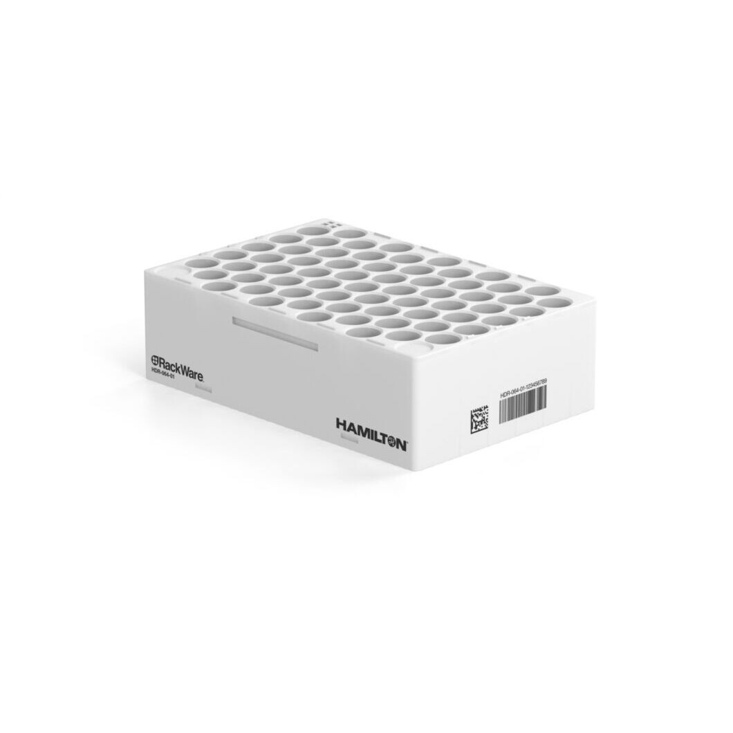

Might be different for the Beckman-specific use case, but on other platforms, this allows you to define labware such as tube racks that are “high-density” in a honeycomb pattern:
Odd and even columns are staggered in the Y-axis in those types of labware so this allows you to specify the offset for odd and for even columns when they are different. This does fit with the hint you see on the Beckman software.
