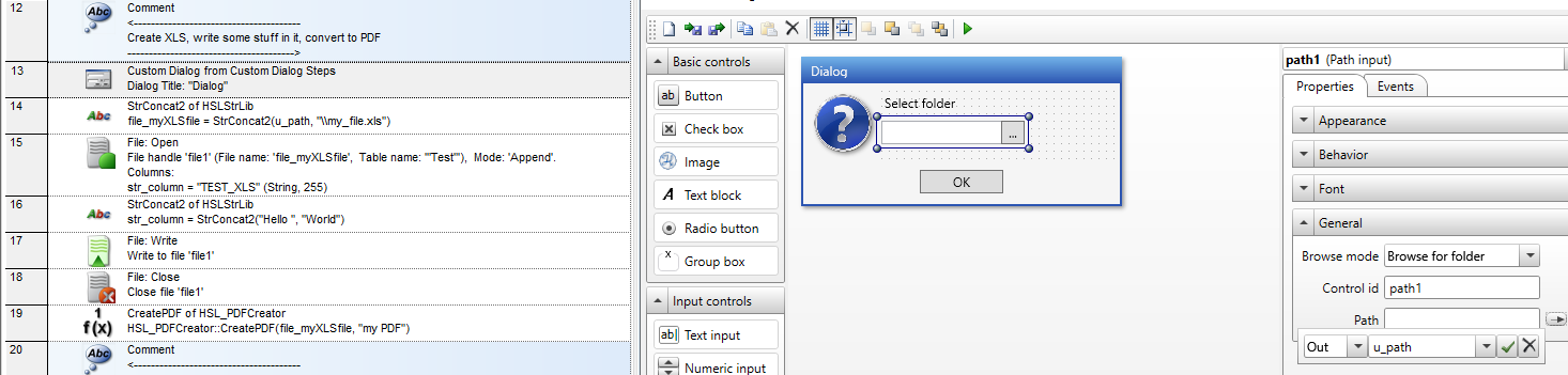

Very straightforward method:
-User browse to select where to save the report

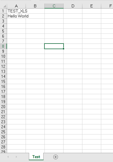

-Create an excel file
-Write something in there
-Close
-Convert to PDF

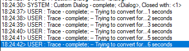

Issue:
-The conversion doesn’t work. Any idea why?

What is HSL_PDFCreator?
Hi @KevinJ,
The PDFCreator library does rely on third party software. Instead, I’d recommend using the Printing library, available at this link. The download has a zip file which includes two libraries: Printing and ZipFiles. No installer is required, but these files should be placed in the “C:\Program Files (x86)\Hamilton\Library\HSLExtensions” folder, which is created during installation of the HSLExtensions library.
