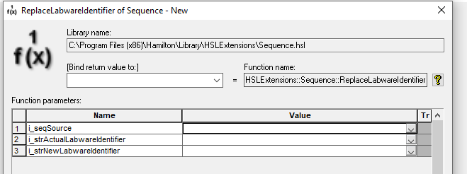

A useful tool you can use here can be found in the ‘Sequence’ library of the HSLExtensions library suite (download here). This installer will place the ‘HSLExtensions’ folder in your ‘HAMILTON\Library’ folder, and contains several libraries. In the ‘Sequence’ library, you’ll find the function ‘ReplaceLabwareIdentifier’, which allows you to input a sequence and its labware ID, and replace the original labware ID with a new one. The new sequence is returned in the [Bind return value to:] parameter.

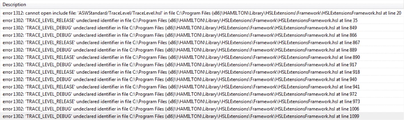

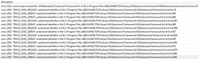

Thank you so much as that is exactly what I needed! I was able to download the library but, once I added it to my method, these syntax errors popped up. How can I fix this?
Hi @Nat,
Those errors are due to a prerequisite library not found on your computer, namely the TraceLevel library. You can get that library by running the installer from this link.
This installer will place the ASWStandard and TraceLevel libraries on your computer. If you continue to run into syntax issues like these, let me know and we can move to a DM to get everything fixed.
