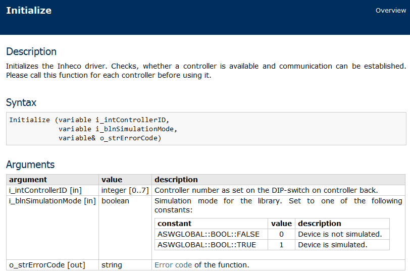

You’ll need to call the Initialize step from the same library before sending other commands to the controller:
Edit: Also, in that snippet you’re not setting CPAC_Device_ID anywhere. If you’re not setting it somewhere else in your method, you’ll want to make sure to set it to 1 to match the slot number.
Thank you very much! Adding these while keeping the Controller_ID set to 0 and the Device_ID set to 1 as suggested got it working.
