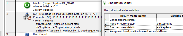

  1. For remaining information, you will need to use a combination of the default HSLMlStarStepReturnLib library and your own calculations. You can download a package file with an example of how to use the Step Return library here. This library works by taking the bound Step Return data string from an instrument step, and extracting the relevant info. To get this Step Return data string, right-click on any ML_STAR command in your method and select “Bind Return Values…”, then assign variables to the data you want (library uses “Step recovery details”).
