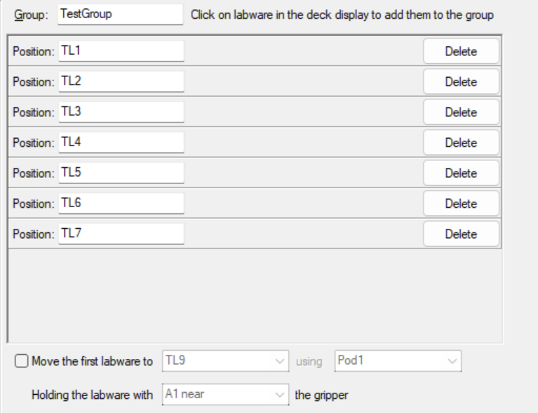

Create Group command:
  • Creating a group without selecting the option checkbox, then querying the group results in an error; TestGroup is undefined.
  • Same test but with checkbox selected, =TestGroup results in the first position, TL1 (but doesn’t move the labware)
  • Using move labware command to move labware from TestGroup to a new position, and TestGroup is still set to TL1

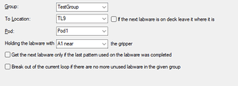

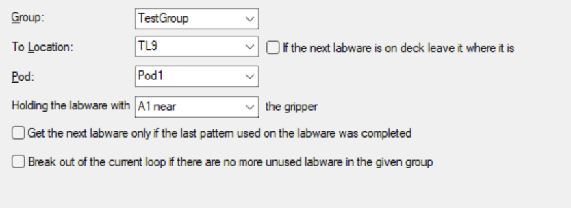

Next Labware Command (This is where it gets weird):
  • Using the “Next Labware” command with no options slected. labware on TL2 (2nd array item) gets moved, and =TestGroup reports TL9, the position that the labware is now sitting on.
  • Selecting the 1st checkbox, “If the next labware is on deck, leave it where it is” results in no labware movement, but =TestGroup now reports TL2, the next item in the array.
  • Selecting the 2nd checkbox results in movement of labware in 1st array item, =TestGroup reports TL9
  • Selecting BOTH results in no movement, =TestGroup reports TL1
So possibly, the Next Labware command moves the labware and advances the array while also recording the intermediate position? Well, not always. The conditionals make this command somewhat difficult to predict and use. Using the serial Next Labware commands will, predictably, move an exhausted tipbox back to its <'Home> position and move the next tipbox out when the checkboxes are properly configured, but =TipGroup itself only reports the intermediate position. I can’t find a way to return different items of that array. This functionality can easily be added scriptwise with some array manipulation, and may be more robust that way.

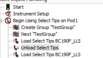

The main reason I wanted to write this post is to demystify these commands a bit and provide any resource outside of the ((limited)) user manual on how these commands interact. Also as a fair warning, it is very easy to crash the software using these commands. Biomek Software has dynamic tip loading (Select Tips) using an intermediate tip re-rack position. If this is used alongside Labware Groups and Next Labware commands, the software WILL crash as soon as validation looks at that command. Select your labware group as the backup tip position and have fun.
If =TestGroup is used as the backup tip location for the load tips command, your software WILL crash.
