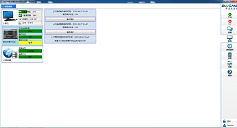

We did thing of this kind before, we use C# to achieve this function (check maintanence date and status, perform maintanence), with following code

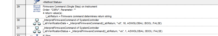

In STAR platforms : C0RV and it will return a string C0RVid0214er00/00vd2002-04-24 12:25vs1
What I do is that I look for vd and cut 16 chars from that, for vs I cut 1 char to the right. Giving me the information. See below screenshot

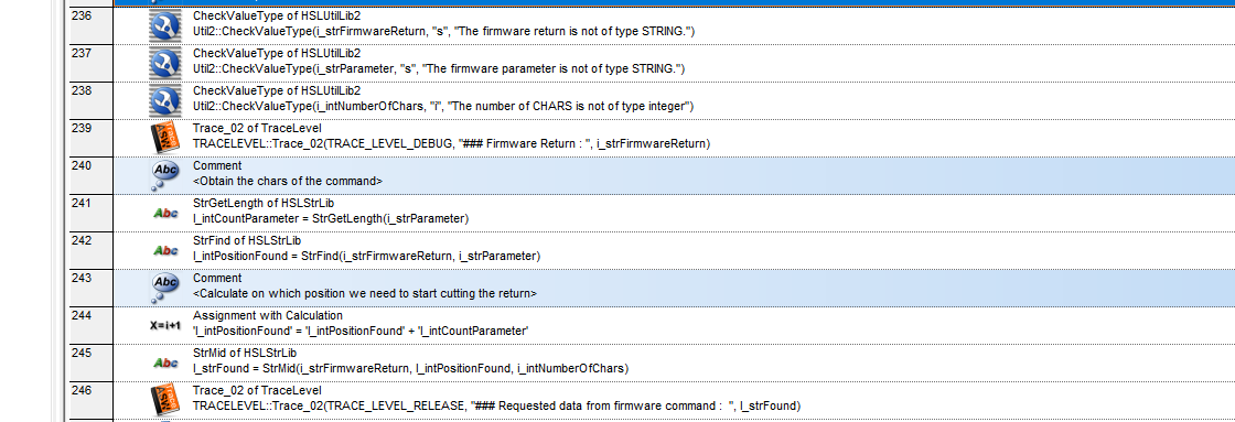

This _InterpretFirmwareCommand looks like

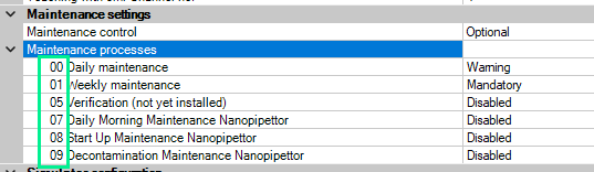

Hi @Pascal ,
If you send parameter vo00, it will return the date, time, and state for Daily Maintenance. The numeric values for this parameter can be found within the system configuration editor under the Maintenance settings:
That did the trick!
So there are 24 more values to obtain? Where can I find documentation about that?
@Pascal ,
The 24 values for vo are only there for additional maintenances to be added in the future. The only ones that will give you meaningful return values are the ones listed in system config editor under Maintenance Settings. Daily, Weekly, etc…

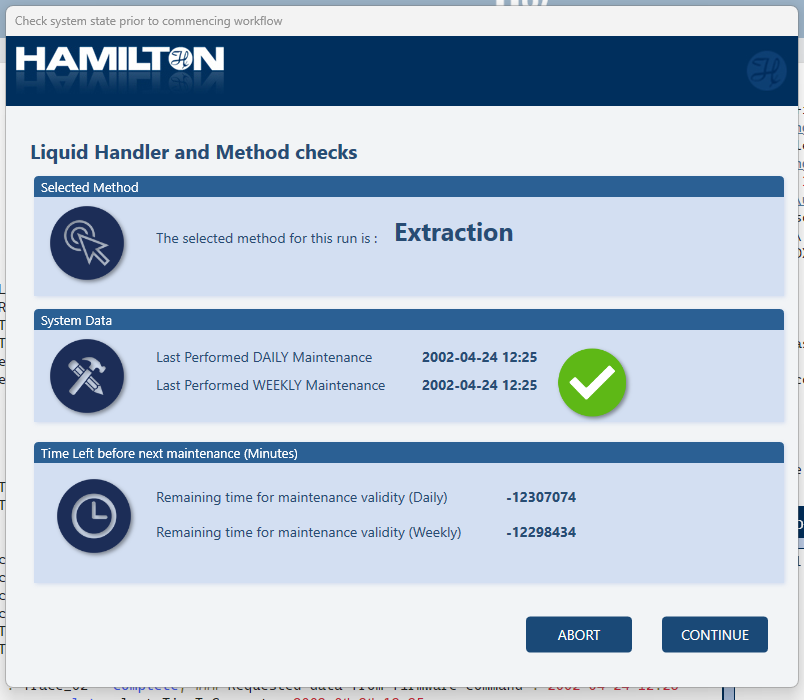

And it works like a charm here :slight_smile:

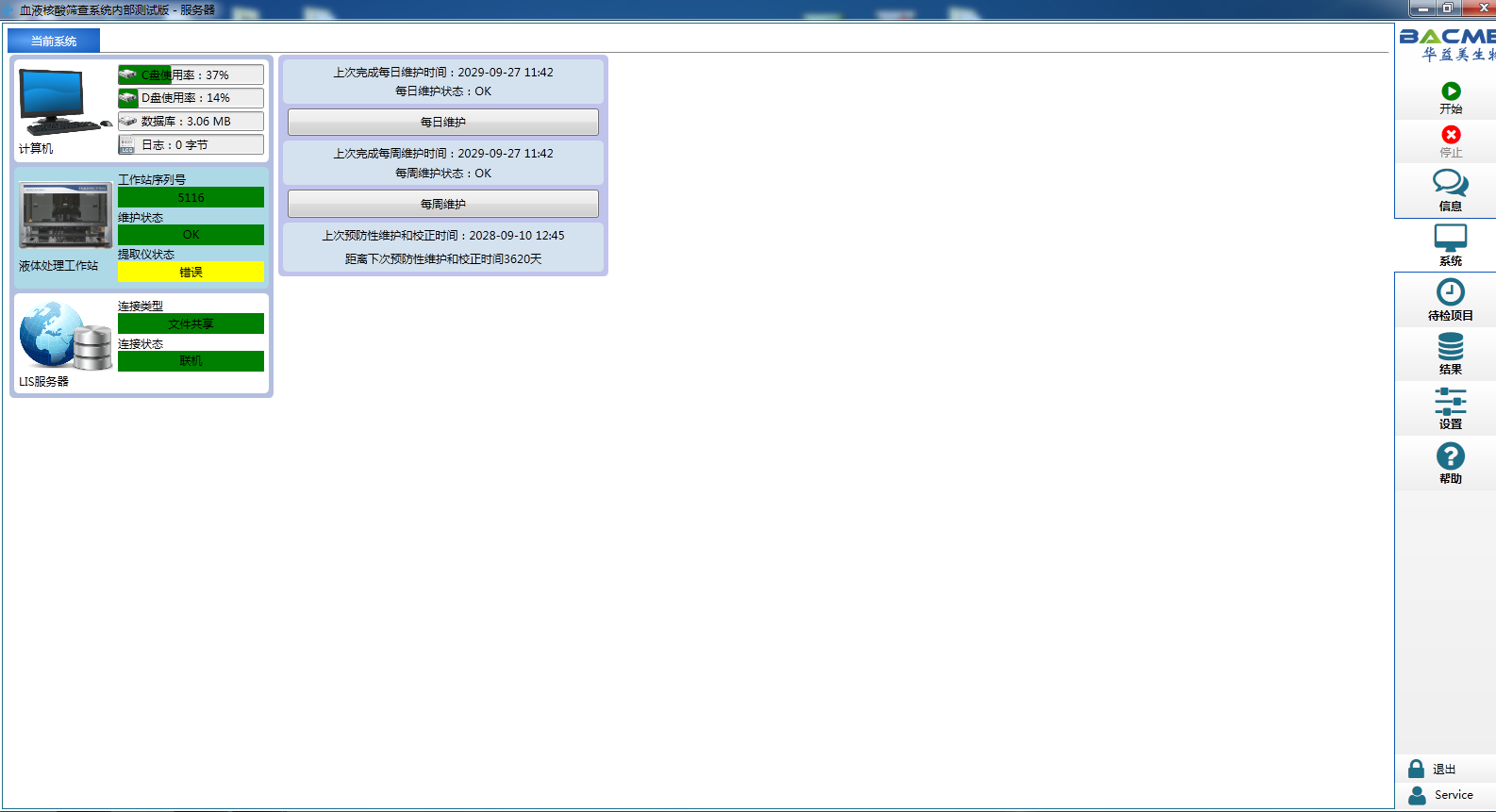

Yes, one can argue that we can prevent this from happening by setting the flag to mandatory, however. this will not trigger <24 hours and <7 days and I don’t want my operators to launch a method with a system that is close to DM. Therefore I added also the remaining time. It calculates the time left in minutes for this action (In simulation it is a weird ass number anyway :slight_smile: )
Looks great! I’d recommend changing the time units to hours and adding in some sort of warning threshold to reiterate your statement that operators should be hesitant to start a method when (for example) one hour remains until the system is technically overdue for weekly maintenance.
This makes me want to add something just like this to my systems as well. It’s a great visual sanity check and good data for logging regardless of user visibility.
Hi @evwolfson this is actually what I changed recently.
The general idea behind this is just a small nudge to the operator. Informing that the system is either in a correct state or needs some attention soon. If I want to do it really good, I should not allow the user to run within 5 hours of the ending of the timer because the longest process I run is 5 hours (the shortest 5 minutes).

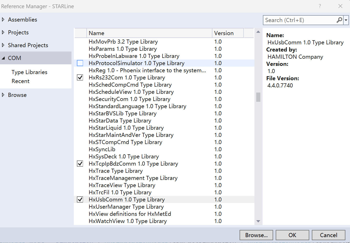

@Huajiang Thank you for sharing your C# code with us.
I have a question. Could you please share the used library containing the class HxUsbComm?
Regards Manuel
HxUsbComm and HxRegistry is the COM objects from Venus software. You add its reference in visual studio by selecting it in reference manager dialog.
