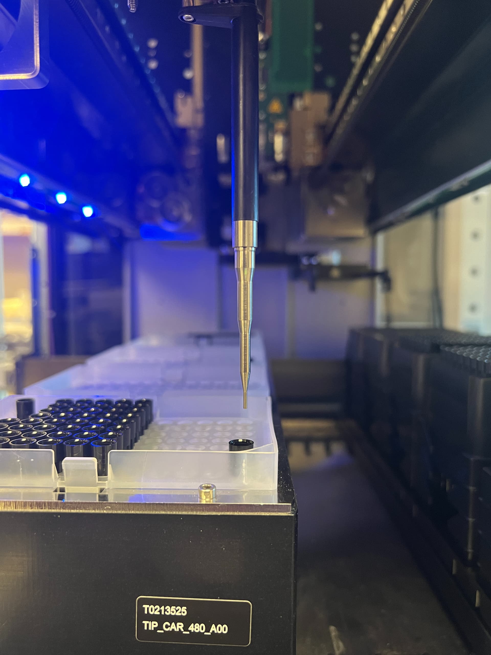

Our lab is having some trouble with labware definitions and using the 8 channel on our Microlab Star. We have noticed that when aspirating/dispensing from some well plates, the 8-head does not pipette directly in the middle of wells, sometimes causing pipetting on the walls or even lifting the plates up. We are confident that the labware definitions are correct, and when trying to use the teaching needle to check positions, it seems like the tip is slightly off centered from the well or pipette tip that it picks up (picture included).
