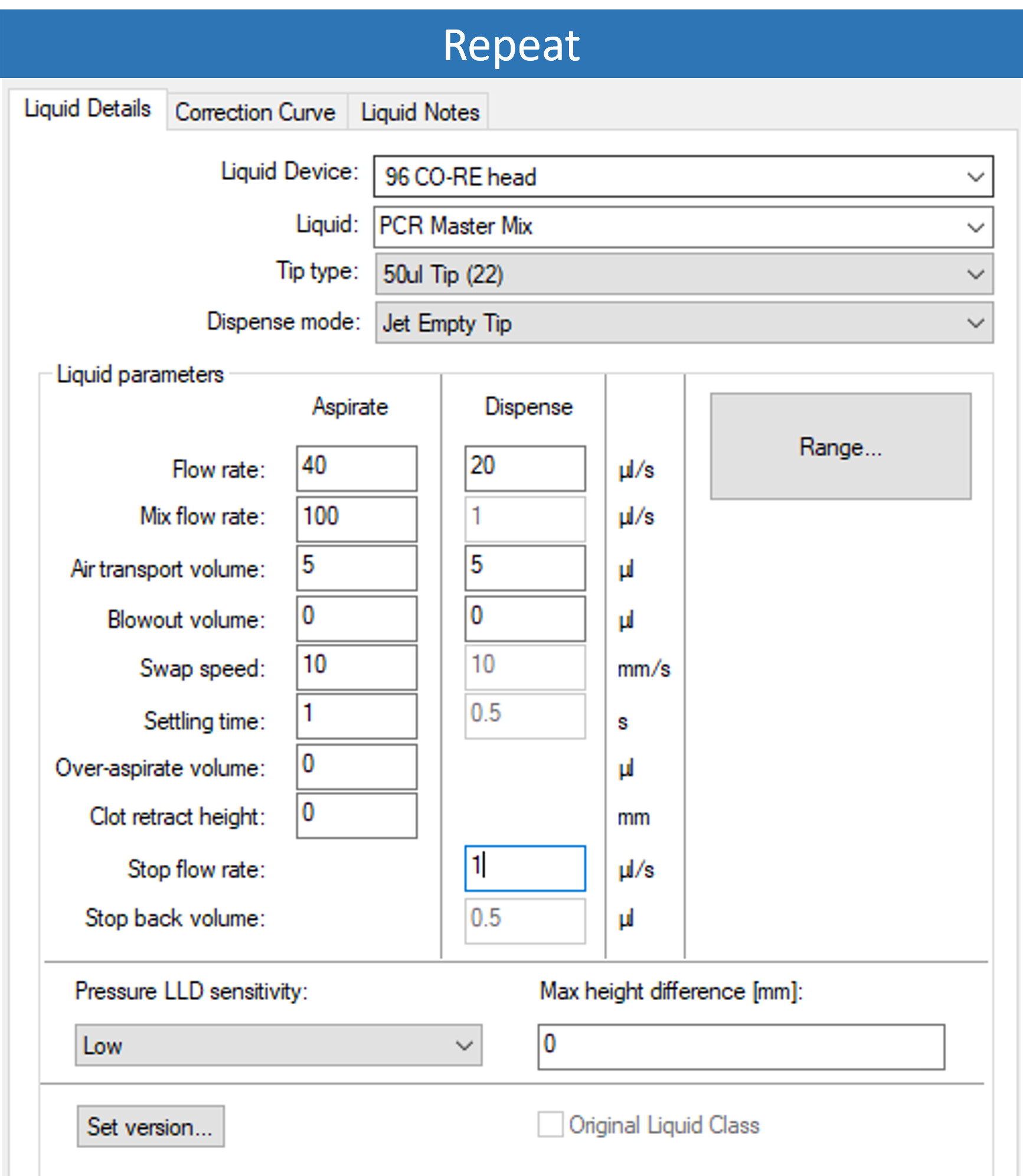

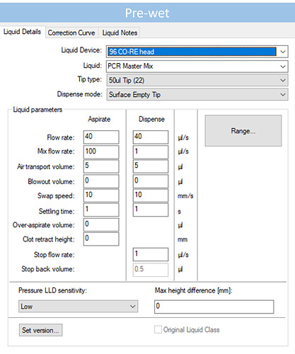

The liquid classes that have given me the best performance for the prewet and repeating single dispense are as follows:
I have been testing with a representative liquid, but after using the actual liquid I have noticed performance is worse (5% vs >10% coefficient of variation). I will have to see if I will be able to test with the real liquid, but even if I can I am not sure what my best options are to proceed.

With your settings, the dispense speed slows down to a creep (i.e. the speed is decelerated to meet the stop flow rate). Usually a sudden stop is better to cut off the liquid and overcome adhesion. Air transport volume is quite high. If you don’t need it, which I would estimate you don’t, I would get rid of it. It can be the cause of bubbles, too. If you need it, I would lower the volume - here you are at 10% of your tip volume.

Your comment about the dispense speed slowing down is also very correct. I have talked to a Hamilton Application Specialist a while ago because I had trouble understanding how the stop flow rate works, he told me not to worry about it, perhaps because I didn’t give enough context. What I do not understand is, how should I set the stop flow rate, is this dependent on my dispense flow rate? Or is there a certain setting which would work with cutting off the dispense fast?
I will also test reducing air transport volume. If I use reverse pipetting, is air transport volume even recommended?
