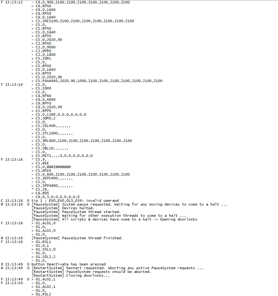

I’m trying to aspirate and dispense liquid using a Tecan Freedom EVO. Aspiration is working fine but I’m running into error EVO_EVO_013_039 on dispense (see the screenshots below). I tried lowering the dispense speed as suggested by the help menu, but this did not change the values in the firmware log and also did not resolve the error.
Does anyone know how to resolve this error? Please let me know if you need more information.
Thanks in advance!
change the dispense speed & breakoff speed in the dispense to < 200 uL/s
i am going to assume your system has 500 uL syringes or 250 uL syringes
Hi, the problem solved. It is indeed a speed problem but the actual problem we had was we were using a temporal liquid class with “>> LIQUID_CLASS_NAME <<” on it, so whatever speed we changed in the liquid didn’t become effective. After changing it to “LIQUID_CLASS_NAME”, it works.
