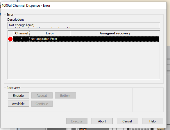

I have a method that watches for clots on the aspiration and records them for the user to manually transfer as needed. The aspiration side works well, but when the sample goes to dispense it throws an error about not having enough liquid (this is also expected). The problem occurs when we push the “Available” button. Instead of going into the well of the DWP to dispense (the default dispense height for samples that don’t error is 10 mm from the bottom) the tip will hover over the top of the well and dispense. This results in bubbles and possible cross-contamination across the plate.
I would like to transfer whatever volume was aspirated, but into the bottom of the well. Does anyone know of a fix for this issue?

Error for reference. The text reads:
“Not enough liquid;
Available are '300.0’ul required are '300.0’ul.”
