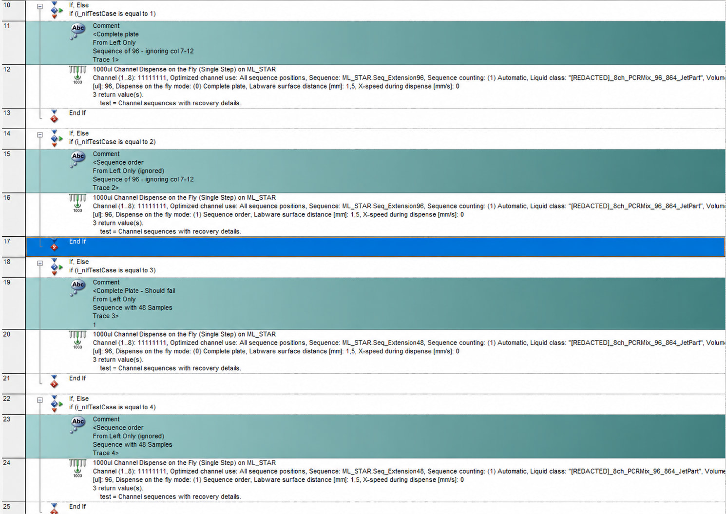

I have encountered an issue with Dispense on the fly single step that I hope you can help me investigate.
The pipetting part of “Dispense on the fly” works flawlessly. However, after dispensing to a plate the system will stop and prompt the “risk for collision” dialog instead of performing an tip eject.
Trace says: [P8: Syntax, Parameter out of range.] and (Parameter out of range or missing parameter …)
(0x28 - 0x1 - 0x3)
I created a test method to investigate further but could not narrow it down further - it seems to be independent of the Dispense on the fly single step’s settings / advanced settings. I can provide logs for these 4 test case if anyone can provide an upload link.

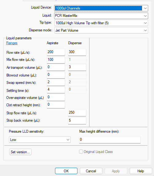

I’m guessing the issue is more related to the liquid class, but the COM Trace will show what the parameter out of range is.

Here is my LC settings, its redacted in above picture, but is still present in the .trc ofcourse:
