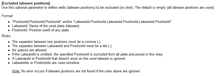

I’m using the dispense on the fly mode and can’t seem to understand how to properly use the excluded wells function. I assumed it would be a sequence, but it only lets me choose variables. Any advice?
Best,
Noah
Hi @NoahK,
The “Exclude labware positions” parameter for Dispense on the Fly requires a comma-delimited string of positions to be skipped (e.g. “B2,C11,G9”). This is why only variables show in the drop-down, as said string would generally be generated then stored in a variable. The Help File opened from the Advanced window has more details:
