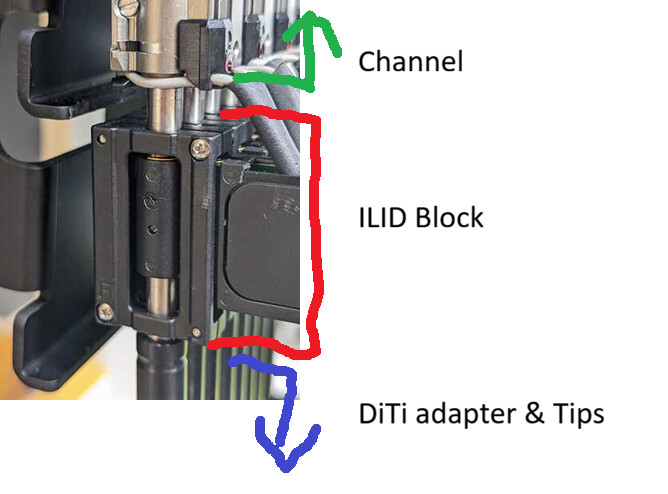

Please refer to this expertly annotated image:
The box I was talking about is the ILID block - it consists of an ILID board (in the flag-shaped compartment hanging off the side of the block) and a DiTi Sensor, which is the open box shaped device surrounding the channel, with screws in the top-right and bottom left. You can also see a black sleeve butting against the ILID block on the bottom. When a tip is physically mounted, that sleeve moves up, and pushes against the DiTi Sensor which will then transmit a signal whether or not the sensor is triggered meaning a tip is/is not mounted.
In the original question, I figured that the sensor might have gone bad, so replacing the DiTi Block would resolve the sensor issue. The parts are slightly different on EVO and Fluent, (and it’s been a few years so I might have a couple part names wrong) so be sure to be specific on what the problem is and what equipment you’re working with.
