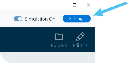

There isn’t a pdf or help document, but the configuration is all found under Settings in the top right.

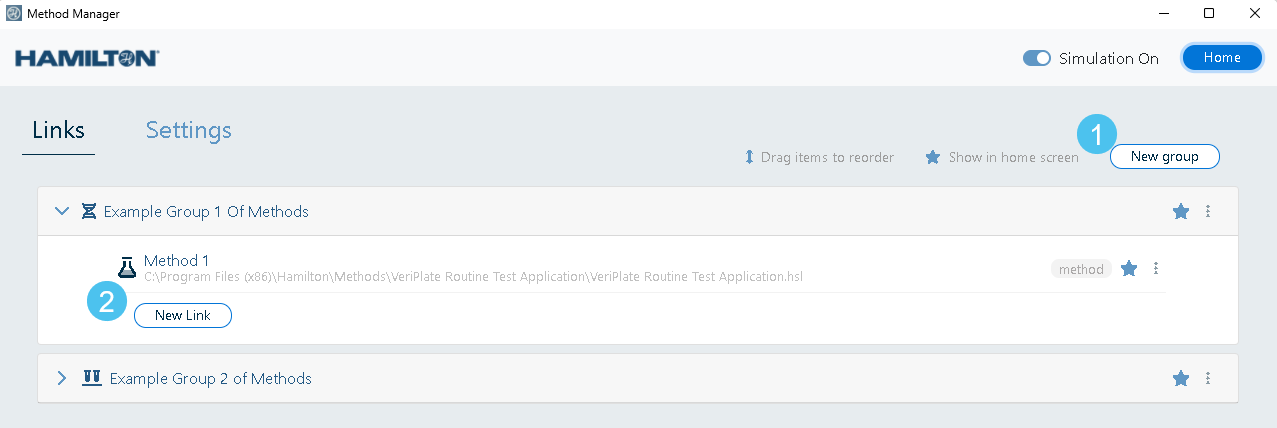

From there, in the Links tab you can create a New Group (1) and within a Group, you can create a New Link (2) to a method, file, etc.

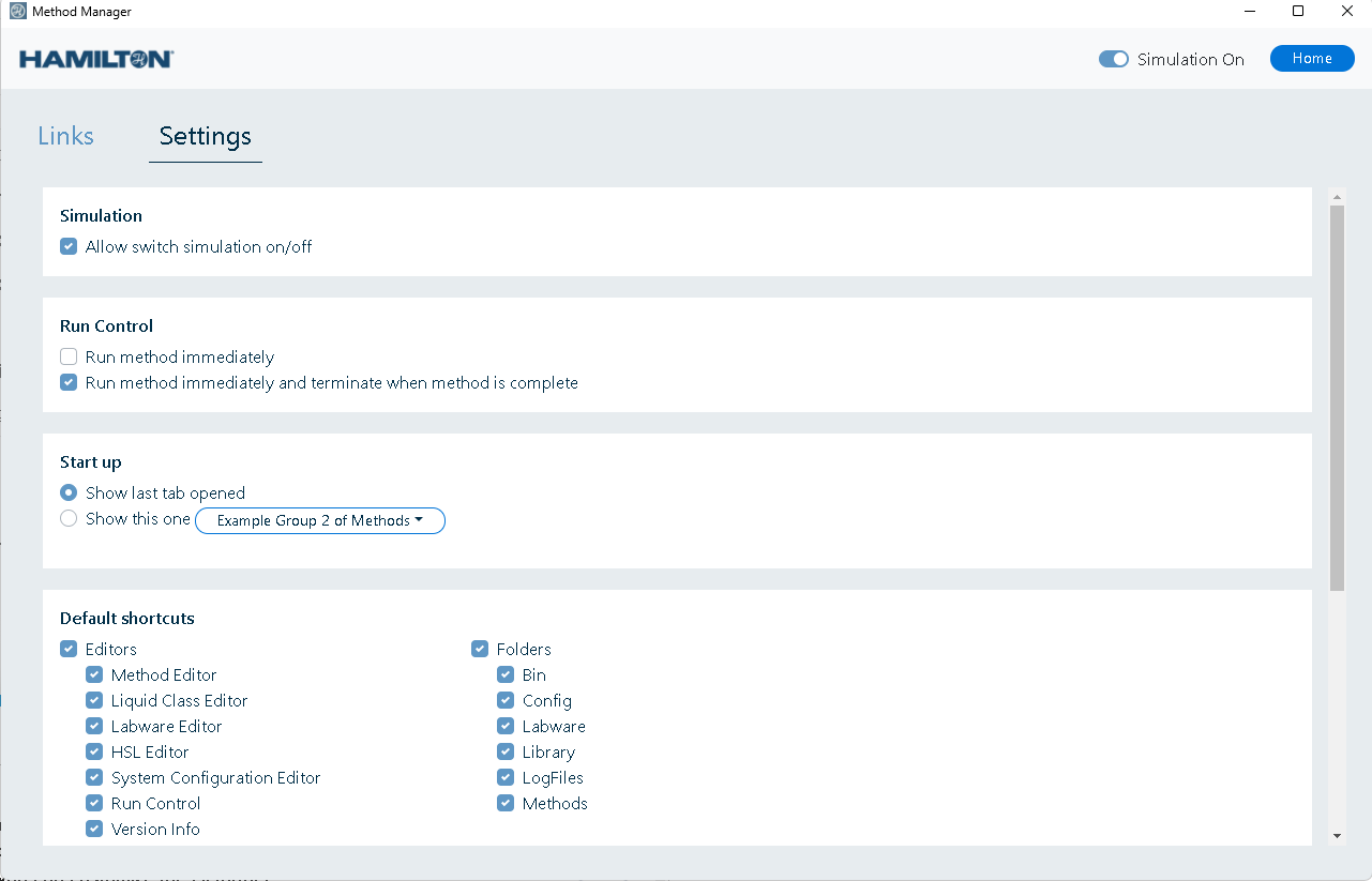

In the Settings tab, you can customize the UI further.
Select Home in the top right corner when complete and the main screens will be updated with the new group(s) and link(s).

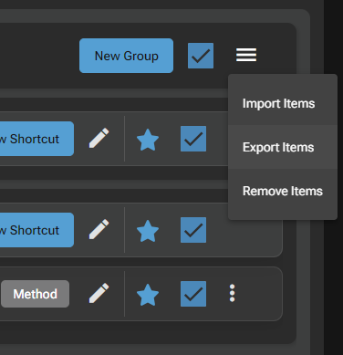

On the chance you’re referring to the new VENUS 6 GUI, I am not aware of a way to programmatically update those links, but it is possible to export/import the shortcuts between PCs by using the menu in the upper-right corner of the Settings page.
