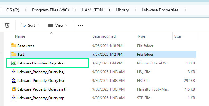

Hi, where can I access the Labware Definition Keys.xlsx?
Hi @aannccllyy ,
This file is imported with Labware Property Query as a dependency:
