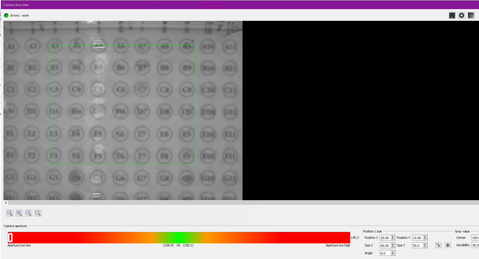

Hey @NickHealy_Hamilton - I’ve followed all instructions RE camera positioning over the light table, yet I still can’t get the entire SBS nest of the light table in the view of the camera at the max z height of the camera. Not sure if I’m missing something here. Thought image stitching was only required for the XL light table. Will I need to image stitch or is this something service should address?

Would you mind sharing an image of the camera view when positioned over the light table?

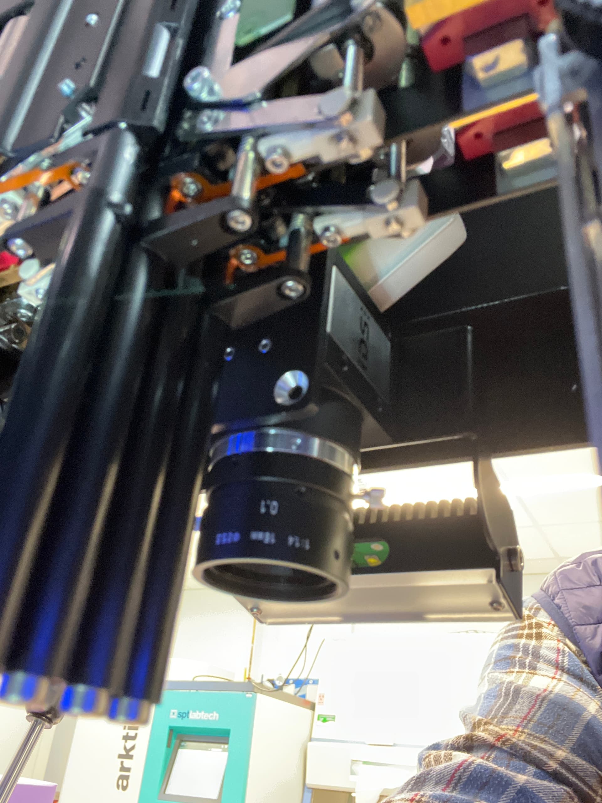

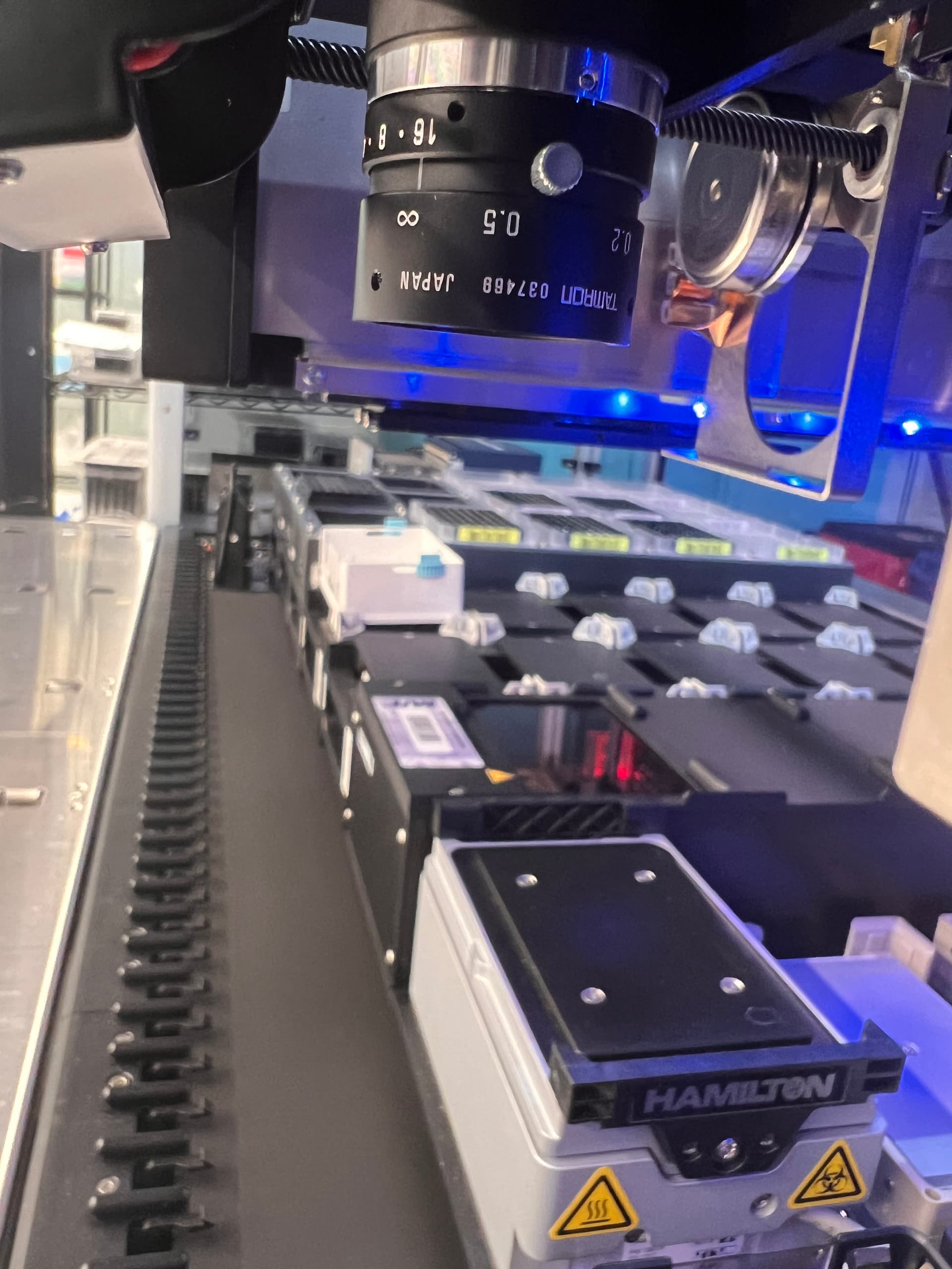

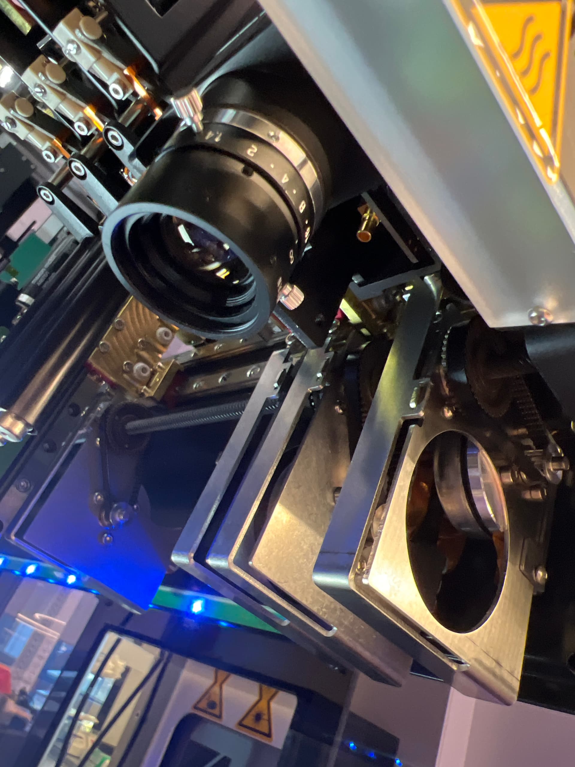

Could you also post an image of the lens mounted to the camera?
If I am not able to provide a concrete solution over the forum, this is something that your local applications team would look into. Image stitching is not going to be needed for the SBS light table, and only functions using special reference points milled into the XL light table.
In the meantime, if you can post the requested images I will advise accordingly. Thanks.
Field of view at z max of sbs agar plate
Images of lens
Hi Austin,
It looks like a different lens was shipped by mistake. That looks like the lens used for easyBlood, which has a different focal length and different range of field of view for the camera channel working distance.
