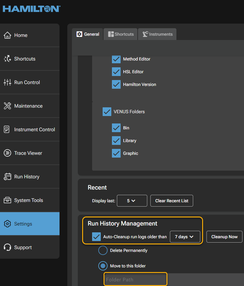

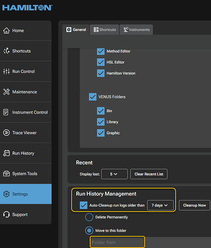

If you are running VENUS 6 or more recent, another option would be to use the automatic log cleanup feature supported by the UI to move all contents of the log files into your networked drive location:
This provides the additional advantage of consistently ensuring the default LogFiles folder for the VENUS installation is of a reasonable size. Given that this folder is actively used by software during runs, extremely large LogFile folder sizes will slow down run time performace.
