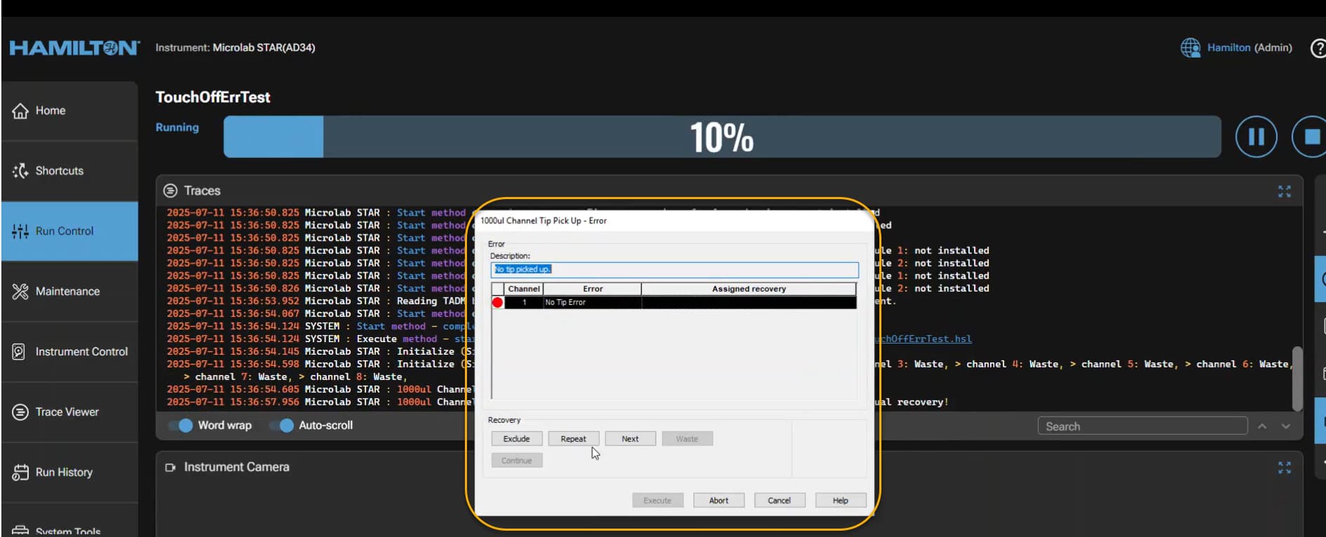

Waiting errors can be considered as any time an instrument error results in a hang in method execution, displaying an error dialog offering recovery options for one or more qualified error categories mapped to the affected instrument step. In other words, any error dialog that looks like the one below:

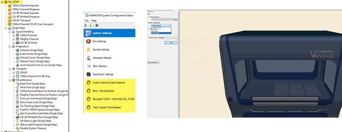

For a step or command to be eligible for mapped error dialogs, they must be from a Hamilton device category using a dependent step from the editor tool box. All VENUS platforms will have at least a pipettor device category (‘ML_STAR’ for STAR and VANTAGE and ‘NIMBUS’ for NIMBUS) but there may be additional system devices depending on the install in question. All possible system devices that will produce waiting errors for any recoverable error will have it’s own category in system configuration editor, as an eligible device that can be added to a decklayout’s system collection (which exposes these commands for any method bound to the deck)
