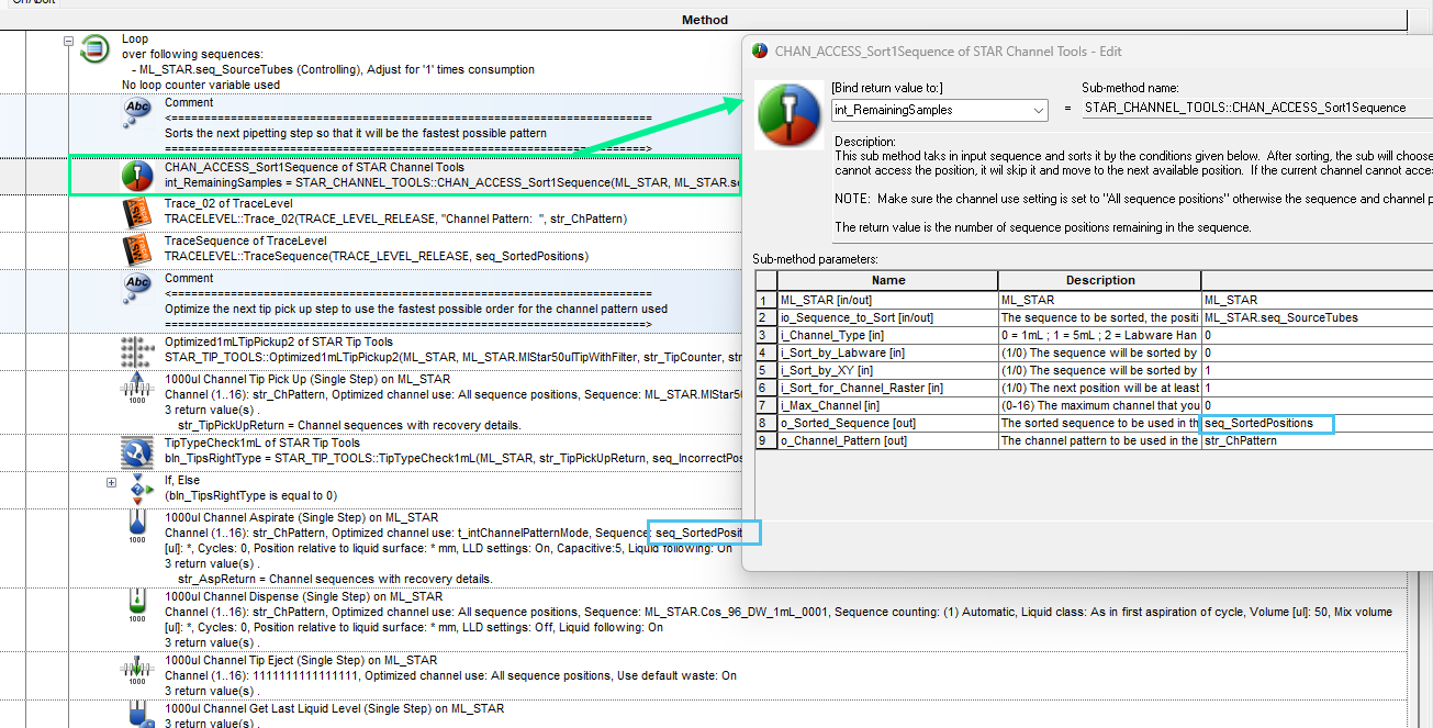

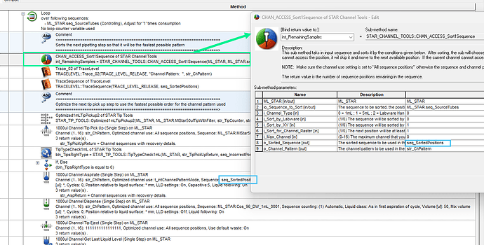

This library is different from other sorting libraries as it does not sort the full sequence up front but rather gets the next N positions that are within the reach of the channels. So, the result from what you have shown should have had 8 sequence positions in ML_STAR.DestAll as it writes to that sequence. The outputs are typically local sequences instead of deck sequences as they get overwritten with each loop. The channel pattern is also an output and not an input parameter.
See below an example of using the function for a pipetting step:
The channel pattern is used to feed the tip pick up, aspiration, and dispense and the output sequence is used in the aspirate. The positions that were used (moved to the output sequence) are then removed from the input sequence, so looping over that sequence will work just fine as that sequence will continue to shrink until all positions are used.
