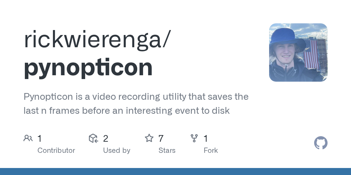

@rickwierenga made a library for this called pynopticon

Are you still maintaining this? I get a lot of module not found errors when I just pip install ![]()

This was just an internal project for our lab and I’m not sure anyone outside of it is using it, but of course it should be maintained.
I just updated the PyPI version:
pip install pynopticon==0.0.8
I also made some dependencies optional depending on what you wanna use. Per the updated README:
pip install pynopticon # basic
pip install 'pynopticon[all]' # all
pip install 'pynopticon[mail]' # mail
pip install 'pynopticon[yt]' # yt
pip install 'pynopticon[server]' # server
Thank you for reporting this and please let me know if you have any other issues!
