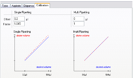

Beside the sample volume, LAG and TAG, you also need to consider Liquid Class Calibration settings.
For example a volume of 30ul with the settings from the following screenshot: 30ul * 1.045 + 0.2 = 31 .55ul plunger movement
