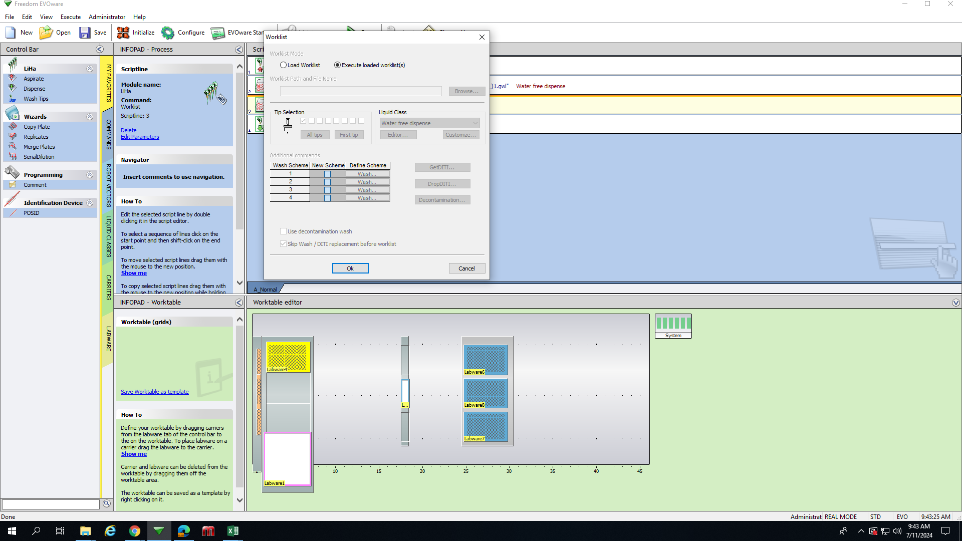

when you insert “load worktlist” command, select all 8 tips here
Thank you for the response.
I tried selecting all 8 tips at load worklist step. It did not change anything for me.
Any other options I could try ?
It is possible to (accidentally) specify the tip that is used for a certain aspirate / dispense operation in the worklist. If you leave that element empty, the system will use all tips that are selected in the load worklist dialogue.
It probably is a silly question, but it looks like the other 7 tips are disabled because it’s blanked out. Are all 8 tips enabled on the EVO config?

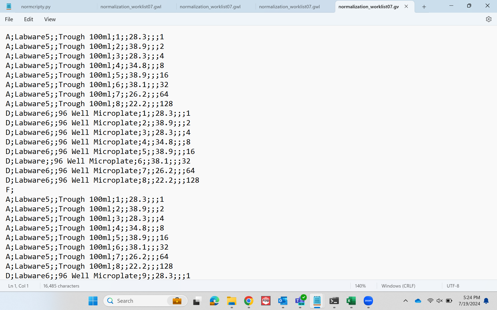

Hi

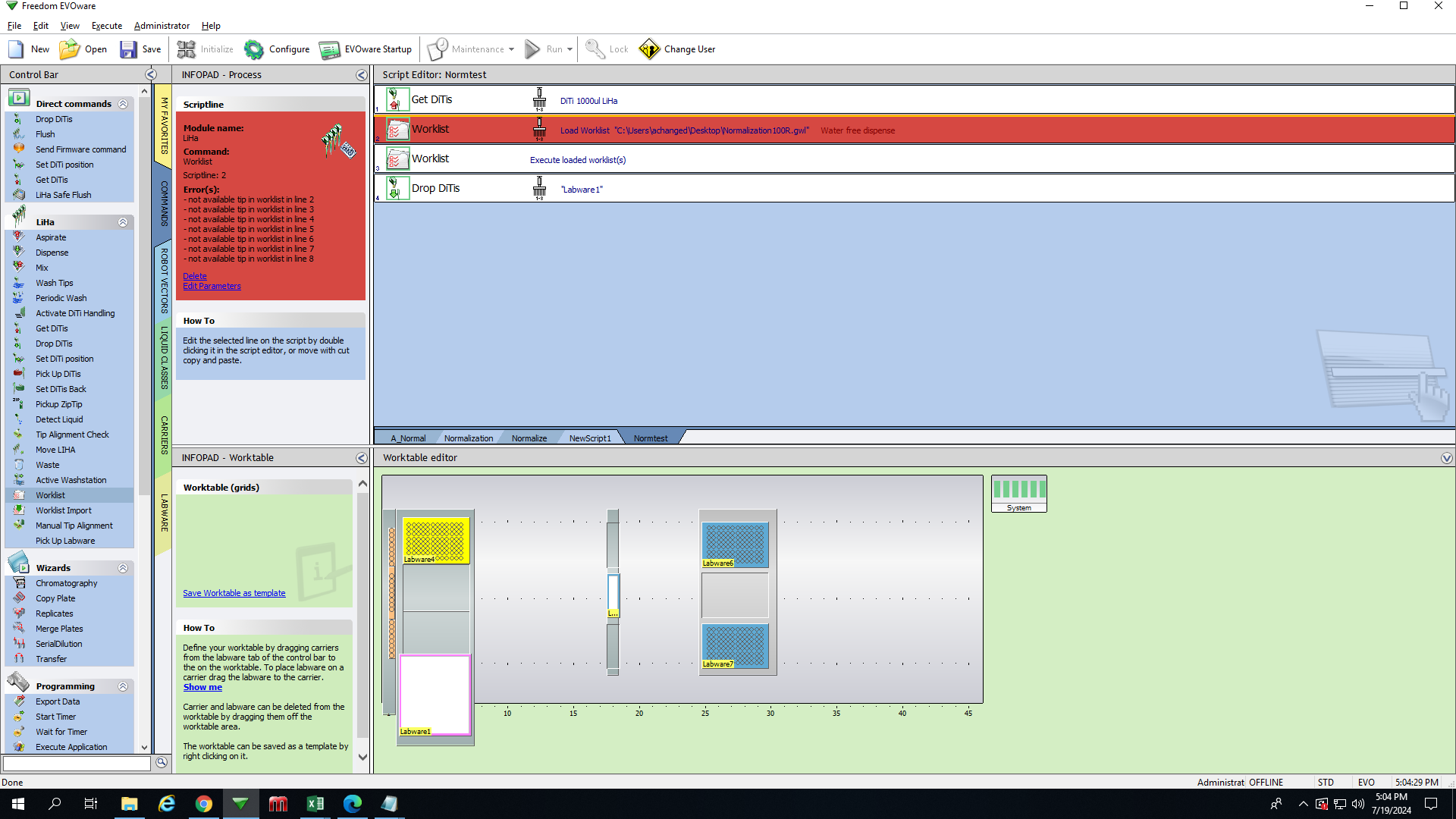

Now I have a new error.
Attached is the error and worklist associated with it.
Please can any one help me with a solution.
Thank you.
Best,
Ashish
you need to adjust the worklist structure,
A; for tip 1
D: for tip 1
F;
A; for tip 2
D: for tip 2
F;
don’t group all the “A” commands together & “D” commands together,
instead, group A/D/F for tip 1, then a second group A/D/F for tip 2

A bit off topic, but do you need step 1 or 4 of this script (Get DiTis / Drop DiTis)?
