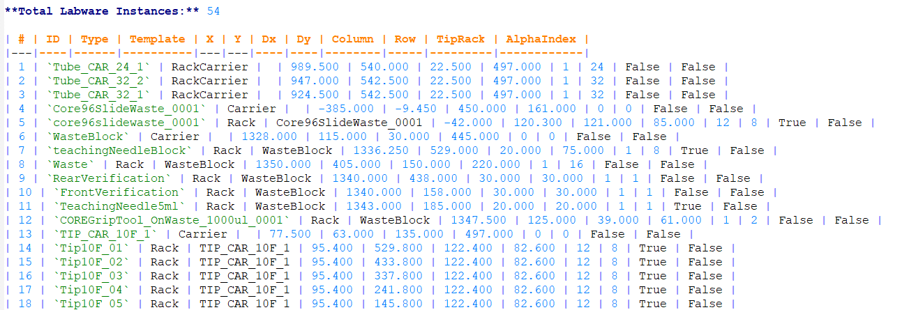

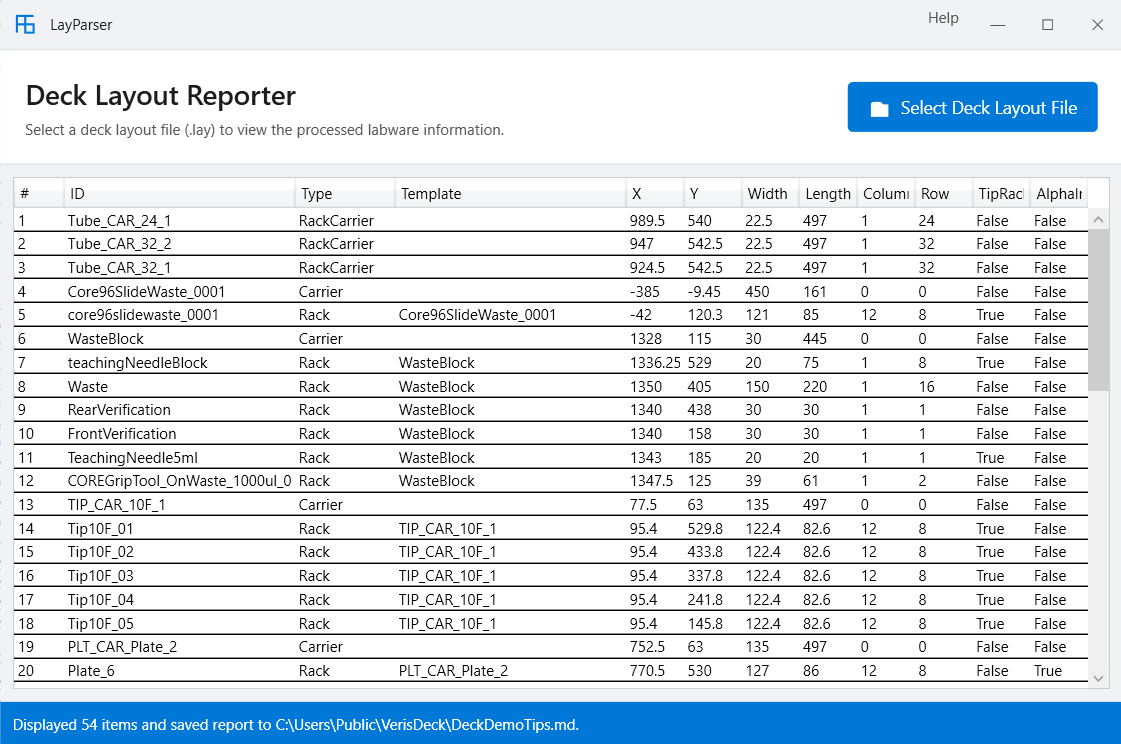

I had developed a tool, which can be easily used to read the deck layout file (.lay) and save the data into a markdown format file.
The program is open-source under the MIT license. GitHub - VerisFlow/LayParser · GitHub
Currently, the program does not read Z coordinates, but I believe it is easy to include it.
