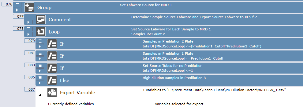

My workflow includes a user-provided list of sample dilution factors from 0x to 1000x, and then my script performs up to 3 fold dilutions across 3 plates to achieve the desired effect. The prepared samples are then moved to an assay plate, which requires a dynamic source labware including the neat tubes and 3 possible dilution plates.
My first thought is to export the source labware label into my worklist, but when using the export function, I do not see a way to control where in the destination file the variables are entered. It appears to default to writing into the wells after any occupied rows (column A at the end of my worklist). Is there any way to control which wells the export function writes to?

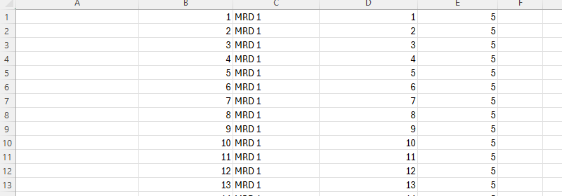

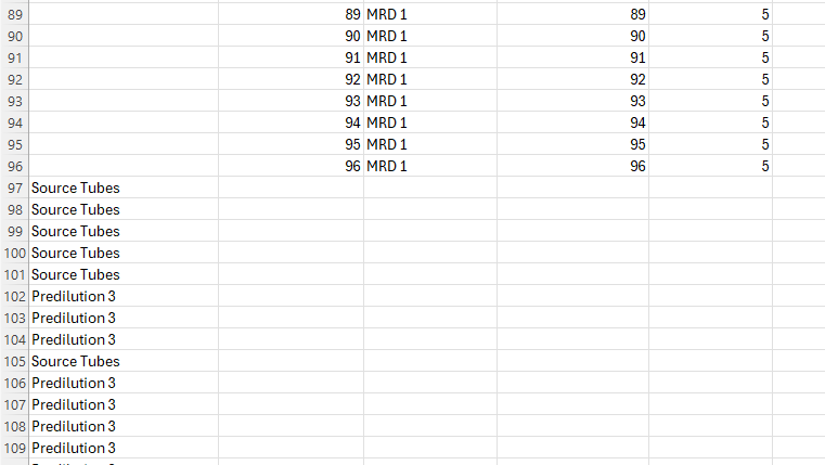

Thanks I’ll try to clarify. I am exporting the source labware string into my worklist CSV. I have an empty column in that file for the source labware to be written into. The Fluent export function writes the variables into A97 rather than A1.

the “export variable” function is pretty limiting - it really only appends to the next available line
