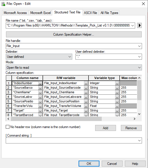

Here is how my File:Open is set up. I updated this to use a comma delimiter after I notice it was set to a “;” but that didn’t seem to change anything.

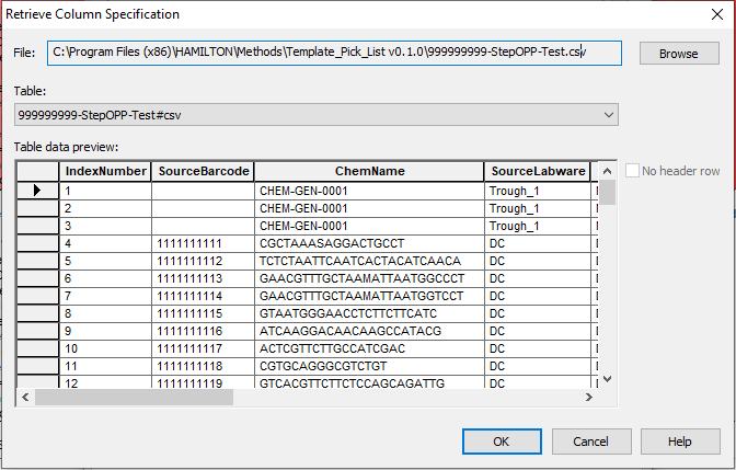

Here is retrieve column specifiation data

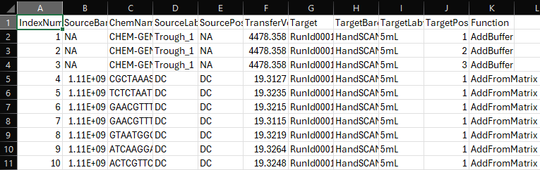

Here is my .csv file that is being read in

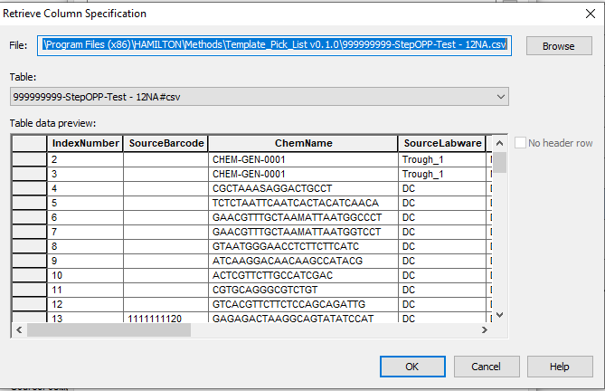

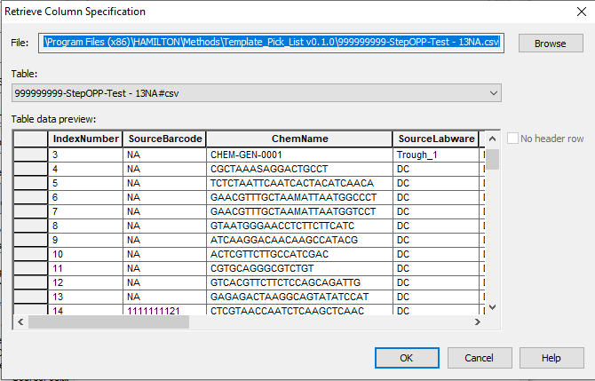

I think this issue has to do with the number of “NA” strings before we reach the cells with serial numbers (int). Through the process of elimination I have found that having <= 12 “NA” prior to a serial number in the csv will result in the File:Open seeing the NA as blank or null, but if I have 13 “NA” prior to a serial number, then File:Open works as expected and reports both the “NA” and serial number in the retrieve column specification. Seems really odd.
12 NAs prior to serial numbers
13NAs prior to serial numbers is able to read the NA strings.
