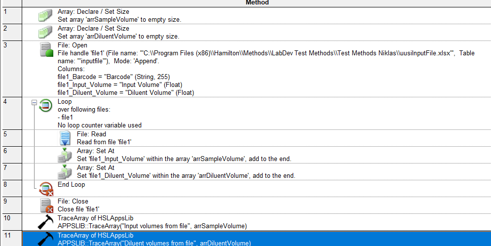

And overall I have suddenly lost file-reading functionality that still worked ok yesterday. I even re-installed Venus but it didn’t help. Like loops that iterate over a file, the script doesn’t even enter those loops anymore, and as a result the arrays inside the loop don’t get populated. This is mysterious.

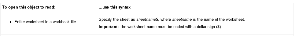

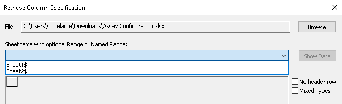

The sheet name refers to the sheets in the *.xls or *.xlsx workbook file. Your file could contain Sheet1, Sheet2, etc. so it needs to be specified. Also, ensure that the sheet name ends in a $ to open the entire sheet as detailed in the html help for the File: Open step - see excerpt below.

I added the $-sign but that didn’t seem to solve it. The files are now uploaded under the link you provided.

Does the workbook include a sheet name of inputfile that is set in your File:Open command? This name should correspond to the sheets in the workbook such as below:
To read from Sheet1 you would put “Sheet1$” in the Sheet name parameter input:
Now it works. Thanks so much, Eric! I don’t know why it got so complicated for my brain :slight_smile:

I haven’t run into issues before with the file preview, but I have exclusively worked with Windows setups. It does require that you have a link to the specific file for the initial setup (not a variable input) and if the workbook contains multiple sheets, then the preview will initially be blank, so you have to select the specified sheet from the drop-down to get the preview.
