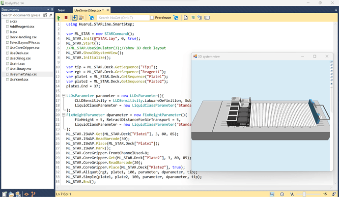

First release of SharpHamilton: use C# script to control STAR and Vantage
I upladed SharpHamilton with C# script editor to github, you can download this small tool from github. SharpHamilton is only an wrapper of Venus into C#, you can programme with C# like venus to control STAR/Vantage. It contains a C# editor, and it support many modern features of IDE, which can make coding easier.
  • controlling STAR/Vantage from venus 4.4 to venus 6 (4.3 was not tested, but I think it will be ok), and support windows xp to windows 11
  • venus styled error handling
  • support deck layout manipulation
  • support 3D deck layout
  • support sequence and smart step
  • ADC, MAD, tip tracking speed, volume calculation for container, plate checking for CORE gripper transport, and more
  • syntax highlight, code completion, code folding, intellisense, refactor
  • version control and diff view
  • support nuget
This tool also support 3D run simulation, but it was not finished, maybe later we can put it into SharpHamilton.
