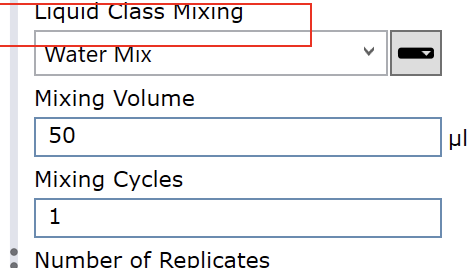

To mix using a Smart Command in FluentControl, create a custom liquid class that includes a mix as part of the dispense by editing the Dispense Microscript for a liquid class. Tecan Expertline can help if needed.

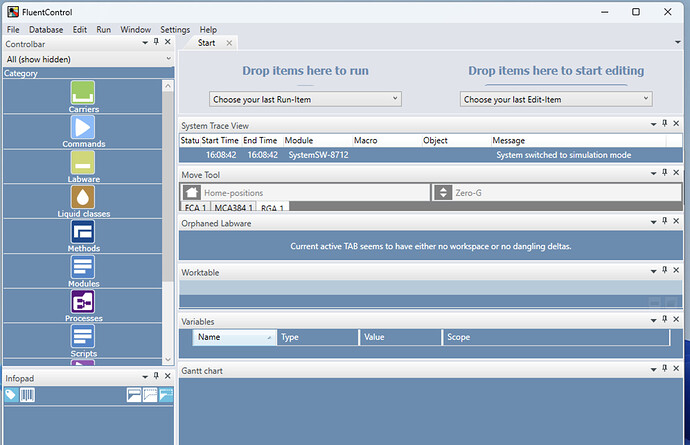

Is there a way to view the runtime values stored in an array? The Variables Viewer doesn’t seem to do this, unless I’m missing something.
What version release was this originally included in? Honestly it’s a great feature that didn’t make the jump from EVOware–>FluentControl and I miss it. It takes away a lot of the dynamic mixing potential that is harder to reproduce inside of microscript. Don’t get me wrong, I love my microscript-heavy LC’s, but it’s not beginner friendly at all and takes a lot of troubleshooting.
I had a “source” that told me that this feature was making a comeback but I haven’t found it as of FCv3.3. A lot of my old Tecan friends have since moved on and I’m learning less and less about new features outside of this forum!
Believe it or not, it’s in the current Dilution smart command. With that said, they’re going to deprecate this command (per the manual) so they recommend not using it but they’ve been saying that for a few versions of FC and it’s still there so…

Not to my knowledge but you can comment them to the AuditTrail to reveal them. You can also check them through the API (both versions of it.)
I don’t really use the Variable Viewer because it has been easier for me to send any parameter to the AuditTrail than it is to run over to the Fluent and navigate a buggy FC interface. What’s your use Variable Viewer case?
I use the Variable View for troubleshooting when a run aborts. My team also writes values for some variables to custom logfiles that we generate using the Export Variable command. Creating these logfiles requires a fair amount of work, and their creation also needs to be debugged…
I should mention that Variable View is of limited use when a run aborts, because while the abort window is present, FluentControl will not allow the user to click anywhere other than on the abort window. And after clicking abort, some user defined variables disappear from the Variable View, which is a maddening bug, in my opinion.

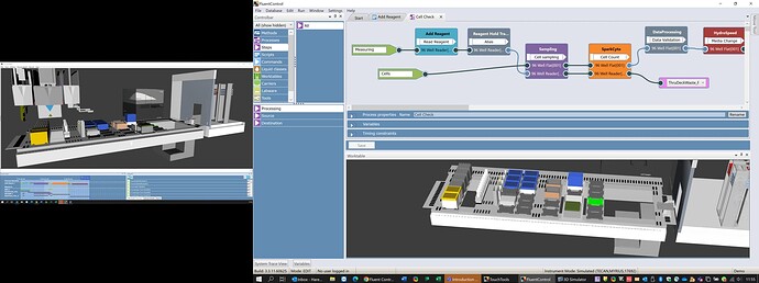

:smile: This is an annoying one. I work for multiple screens so I think its design that you can pull each window on to extended screens an build a workspace. So I tend to have a main coding screen with simulation and/or worktable windows on other screens. Makes life less painful.
Example:
