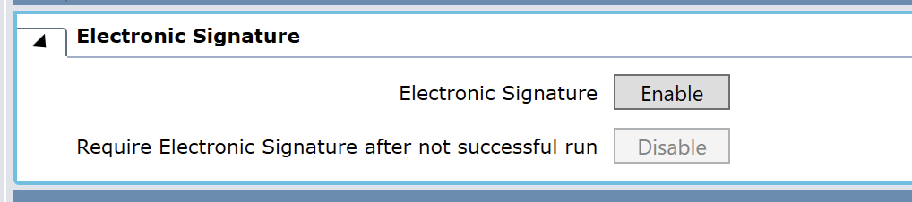

Electronic Signatures are a function one can turn on somewhere in the User Management Settings.

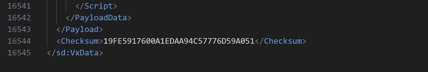

There’s also the Checksum at the end of the XML.
You can enable electronic signatures to make it very annoying to make any changes on the Tecan

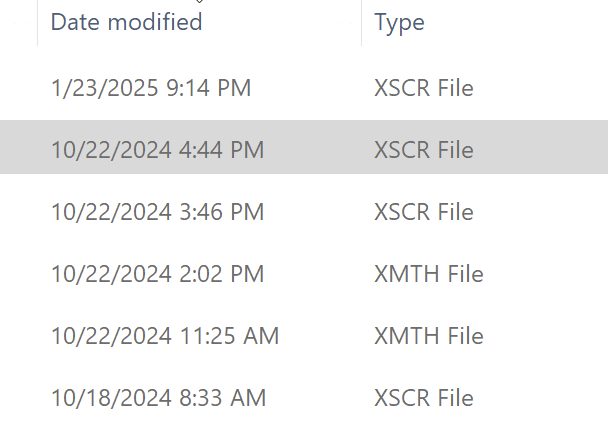

If you’re interested in something less programmatic you can also query for when these files were Date Saved or Date Modified and that can be done external to the software
