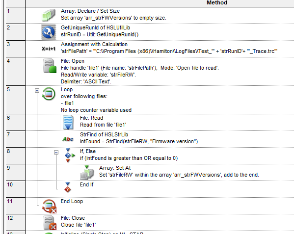

I wrote a code snippet below that is a fairly simple way of extracting the firmware versions directly from the Trace file:
Outlined:
Use the default library HSLUtilLibâs âGetUniqueRunIdâ function to get the Run GUID which is generated as part of the Trace file name. Concatenate this with the LogFiles directory, method name, and suffix/extension to generate the current runâs Trace File Path.
Use a File: Open command to open the Trace file as an âASCII Fileâ, loop over said file and check if the given line contains the substring âFirmware versionâ. If so, add to an array.
The method and trace will pick up from this point and continue normally.
