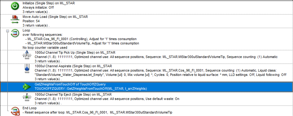

I have a function that can return the Z heights that were measured when using a touch off aspiration / dispense. It is currently set up for STAR, but not Vantage. What instrument type do you have?

The example method which contains the library can be downloaded from the link bellow:
The function will return the Z height that was measured when touch off was used in an aspirate/dispense step. The array will always have the number of index positions per channel but will return 0 if the channel does not have a tip loaded on it.
The method is written in reference to a STAR, but the library was updated to work with both STAR and Vantage.
