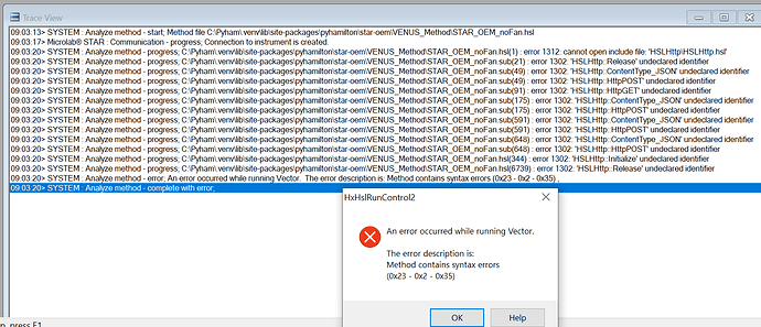

I’m excited to try Pyhamilton, but I am having some trouble getting started. I’m running this in simulation on my PC to get it working before I try to use it connected to a Hamilton. The script runs, and opens Run control, but it fails while analyzing the method due to ā€œsyntax errors: 0x23 0x2 0x35ā€. I’ve had this error previously, when I was first installing Hamilton and it came down to not having the correct Hamilton libraries installed. In this case, I can see that the library is installed. Has anyone else encountered this issue?

Did you run pyhamilton-configure and proceed with all the executables? One thing you can check is whether you can run a test Venus method that just imports the HTTP library and runs some HTTP functions as a test. If that doesn’t work, this is a Venus issue.
Check out the library downloads thread and see if there’s an HTTP installer in there that works. If not, tag one of the Hamilton folks and ask for an updated installer for your combination of Windows and Venus versions.

I did start with pyahmilton-configure. As far as I can tell, everything installed.
I will try running a test method to import the HTTP library, thank you!
I had to get IT to give me permission to install the library, but I finally did and it worked. I’m so excited to try this out. Now I can finally get started.
