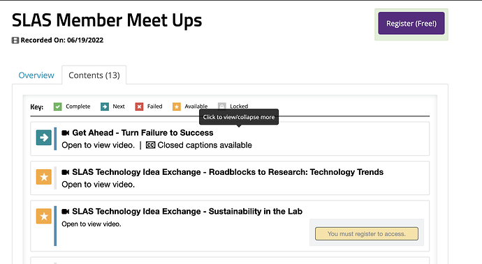

Also FYI there was an SLAS Technology Idea Exchange webinar on the ā€œChallenges to Consumable Reuseā€ which I thought was pretty interesting. They talked about both products and other areas of concern… like the psychological concerns labs will undoubtedly having about reusing tips.
Find it like this (because the website is a mess to navigate): SLAS → Applied Learning → Webinars → 2022 Webinars → SLAS Member Meet Ups
