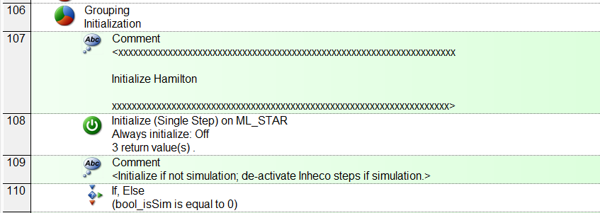

I’m working on modifying a legacy Venus 4 method and have found that the collapsibility is entirely lost for all normally collapsible lines. Without me having to manually rewrite this entire method, has anyone seen this bug before and/or know of a fix?
Bug Features:
  • Creating new method and copying code over via copy/paste has collapsibility, but loses it once saved and reopened.
  • Local submethods within this method still have collapsibility.
  • Any new method made with the same software install has collapsibility.
  • Opening this bugged method in other Venus instances still has the bug.
Best,
Bryce
