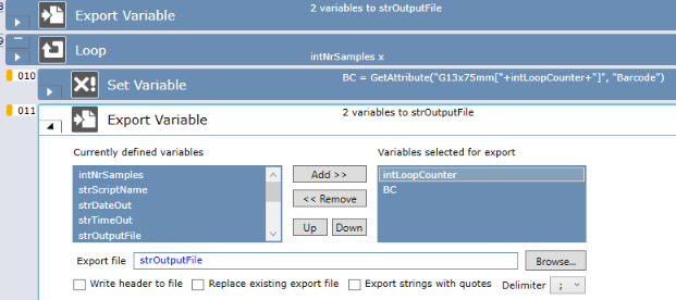

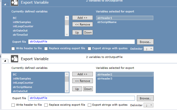

To compose the report, I use several Export Variable commands to write the variables in the rows I want them to be.
I do generate them usually in csv, as we use them in downstream processes often, but I guess with some VB.net or some other script ran with the Start Application, you could print them as pdf.
See an example of a simple script that scans tubes in Fluent ID and prints the barcodes in a csv.

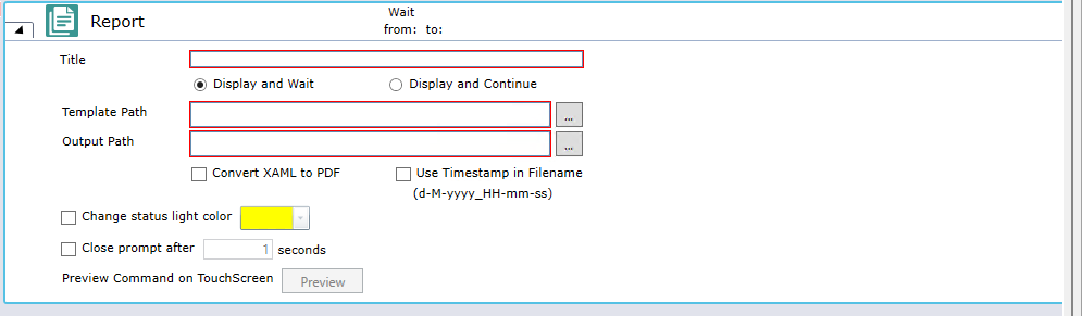

In addition to what Optimize said, have you tried using the Report Function. You can probably make your own template and do a xaml to pdf possibly? In the xaml file you can pass variables and create the desired report.
