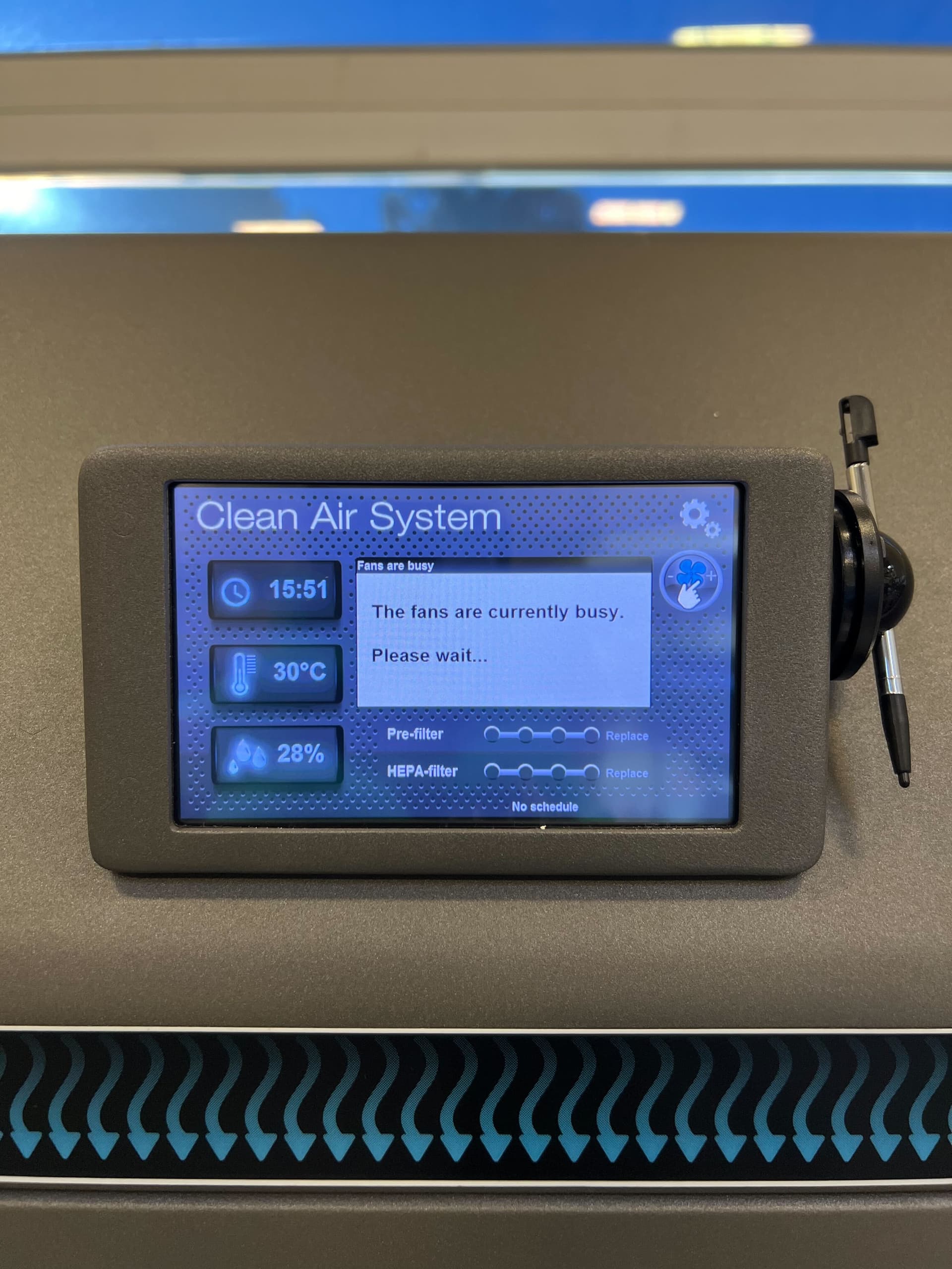

Hello all!
I recently purchased a secondhand STAR HEPA. Everything appears to be in great condition, but it turns off the fans immediately after starting them. The light works, the environmental reporting works, the only thing that doesn’t work is the reason we bought it… The same behavior happens whether it’s being run through venus or the touchscreen, and there is never any error reported in venus.
Since it’s secondhand, I imagine we’re on our own for actually fixing it, but I was wondering if anyone had any idea what the root cause might be that would cause this immediate shut-down.

As for the specific issue with this CAP, it might be drawing too much amperage and is shutting down. The recommendation is to have a Hamilton service visit, but I understand that this was bought secondhand so the support options may be limited. You can reach out to the service hotline to determine what may be possible though!
