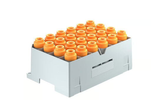

Our instrument usage is very low (centrifuge runs max 16 times a week), our settings are all within spec (5000 acceleration, 4200 max speed). We are running Autolys racks with Autolys tubes. I checked our balance racks with various numbers of tubes - and we are always < 1g difference between balance and sample racks (manual says up to 6g is tolerated).
