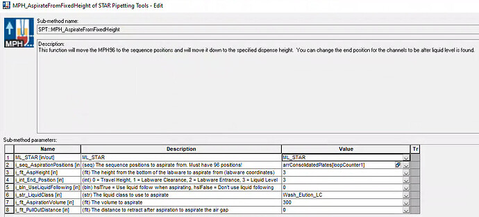

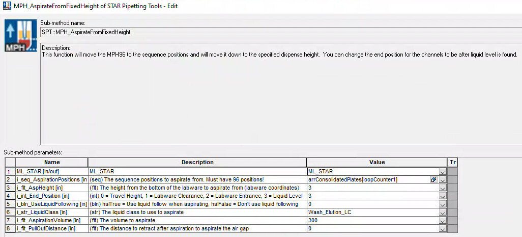

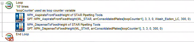

If you require the tips to stay submerged in the liquid, I recommend using the STAR Pipetting Tools library. Example below:
Likewise for the individual channels, you would use their respective functions:
Hey! For what I’m looking for, this is probably my best option. We found that when the tip was removed from the liquid during mixing, it lost “momentum” and was unable to resume at the same rate for several mix cycles. Can you tell me where I can find this library?
It’s part of the STAR Tools Suite, which you can find here.
