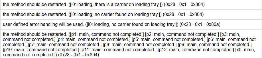

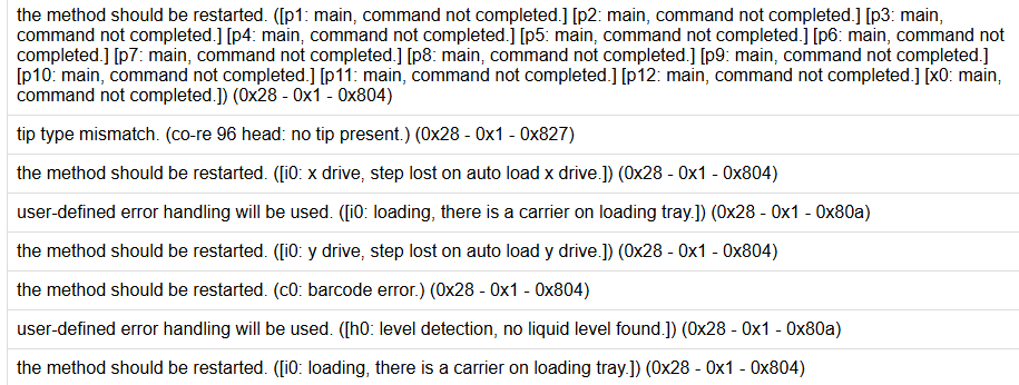

Hey thanks for the message, Pascal. So, actually, I think I’m more interested in the error descriptions displayed in the log files now that I think about it. Does Hamilton have a list of all possible error messages and possibly a list of potential causes for each error message? Sometimes the error message is descriptive enough for you to figure out what is going on, sometimes it is confusing.
So error descriptions like this:
It epnds, there is a difference in errors but it always comes down on understanding what is programmed. For example, a barcode error (just a simple reading error) can cause your datahandling to fail. The error message would then point towards your datahandling whilst in reality it is aimed towards your barcode reading.

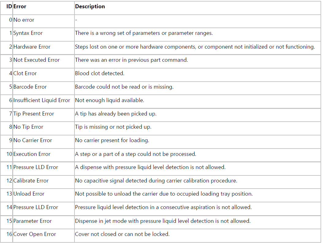

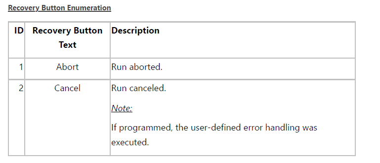

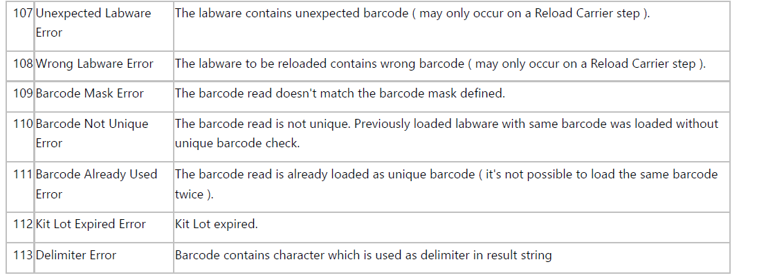

@trand16 if you are familliair with StepReturnValues there are alot of those documented. However, I included some screenshots from a document I am using for years now.
When I developed my own set of datahandling SMT’s I got these all in a PDF. But you can also look for these in the firmware refernce guides.
