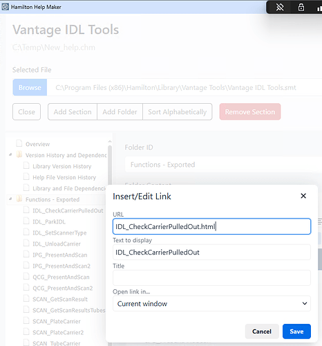

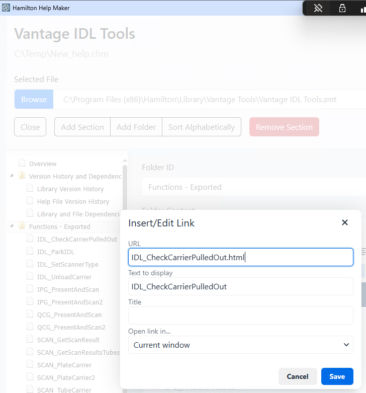

- When adding link, the URL you need to enter for your individual page is is the “NameofthePage.html”. Thanks @WillEb for the help there!
I.E. IDL_CheckCarrierPulledOut → IDL_CheckCarrierPulledOut.html
