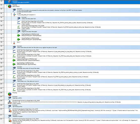

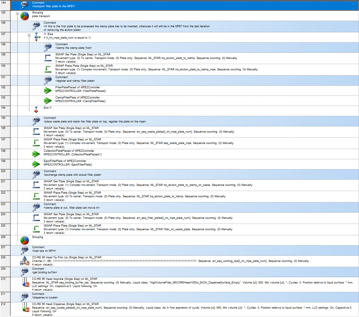

Sure, here you go:
A bit messy with the screenshots, but I did not find another quick solution. As I’m using half-skirted filter plates I have to use an intermediate clamp plate as otherwise the nozzles touch the bottom of the MPE.
L190: I place the clamp plate
L192: I register it as a filter plate (FilterPlatePlaced())
L193: Clamping the filter plate –> Clamp plate is in, bottom shuttle comes out
L197: I place my collection plate (which collects waste at this point)
L198: I register the Collection plate, (CollectionPlatePlaced(1))
L199: I eject the Filter plate BUT do not deregister it (I think this may be the key)
L201-205: I remove the clamping plate (a regular full-skirted PCR plate) and place the actual half-skirted filter plate

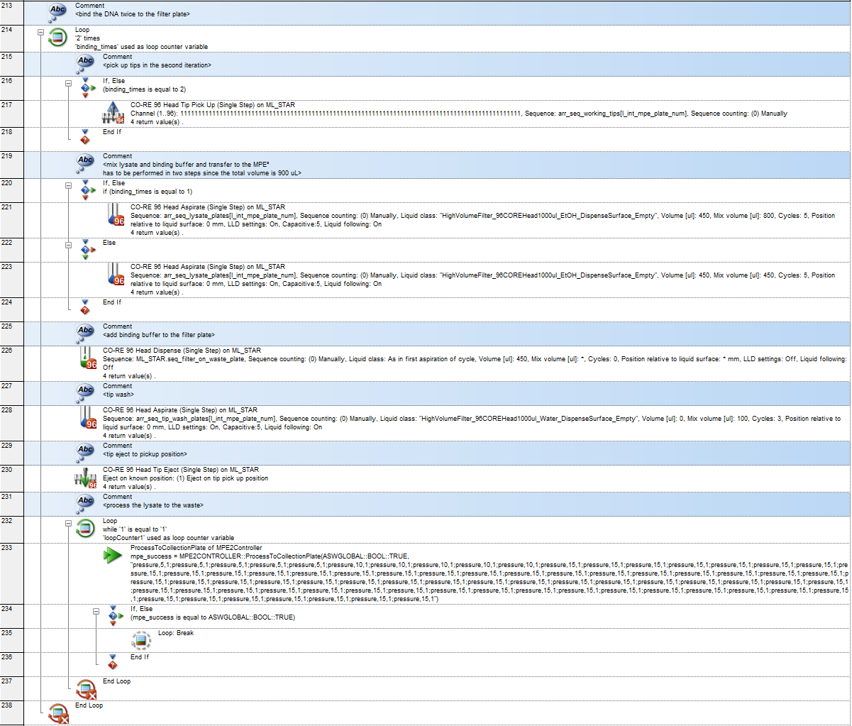

L233: I process to collection plate. Dont be confused by my control points: As one of the sensors in my MPE pressure modules is bricked I bypass the pressure control by applying pressure in 1 second steps.
After the processing the entire stack is ejected and I can pipette again, process again etc.
Do you also need the processing steps for the elution?
best
Dominik
it’s working! Thanks a lot. Obviously the issue was that I unregistered the plate.
