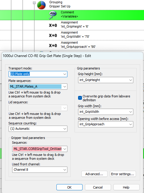

Morning Brandon. I am using Hamilton grippers to pick up plates from the Hamilton heater shaker off the deck. Do you have any recommended parameters for picking them up? The plate is a little snug to the heater shakers and so I takes a little more to pull it off using the automated grippers.
I am having success with:
Grip width (mm): 75
Opening width before access (mm): 90
Grip height (mm): 4
But this bends the channels slightly. I don’t know if this is healthy for the machine over time. But if I go to a larger grip width, it isn’t strong enough to pick up the plate.
Thank you!!
David Tran
Hi @trand16 ,
I would recommend making a new post regarding this question as it doesn’t pertain to TADM.
Is the HHS currently clamped at the time when you are trying to remove the plates? How far off deck are the HHS?
If you are gripping the plate close enough that it bends the channels, then you are gripping too hard. For most plates gripping 80 with a 90 open width will do the trick, but it also depends on the labware itself.
Okay thanks! When I switched to this, this worked:
Grip width (mm): 78
Opening width before access (mm): 85
Grip height (mm): 4
