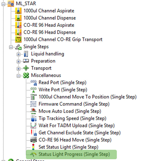

Does anyone know how to control the Status Bar on the Vantage? During a run it is stuck at like 20% the whole time. I was wondering if there is a library or something I can implement to move the status bar when it reaches certain parts of my script.

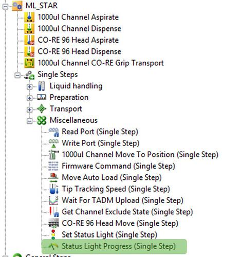

It’s a standard command in the “Single Steps” section of your instrument.
If you can’t find it there, check the “Step Selection” of your instrument in the System Configuration Editor, that this step is set to “Step visible”:
HTH
Thank you! It was hidden which is why I couldn’t find it.
