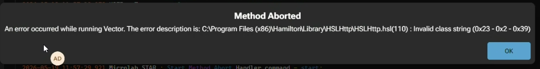

I was able to get a Venus 6 method working on a PC that was connected to a Hamilton instrument. I exported the package and imported the method to my laptop. However, when i ran the method on the laptop, i ran into a HSLHttp.hsl error. This didnt occurred before the export from original PC. I went to HSL Editor, went to line 110 and couldnt find an issue with it (well i assume no issue because the one on the laptop looks identical to the one on the instrument. Any help would be great!

You’ll need to run the installer for the HTTP library on your laptop. A common source of the ‘Invalid Class String’ error is a missing or incomplete installation of the specified library
