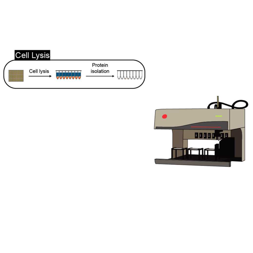

Hi, these guys did the automated chloroform-methanol extraction on a Biomek FX. You can check it out. I suppose you can contact the authors if you want.
