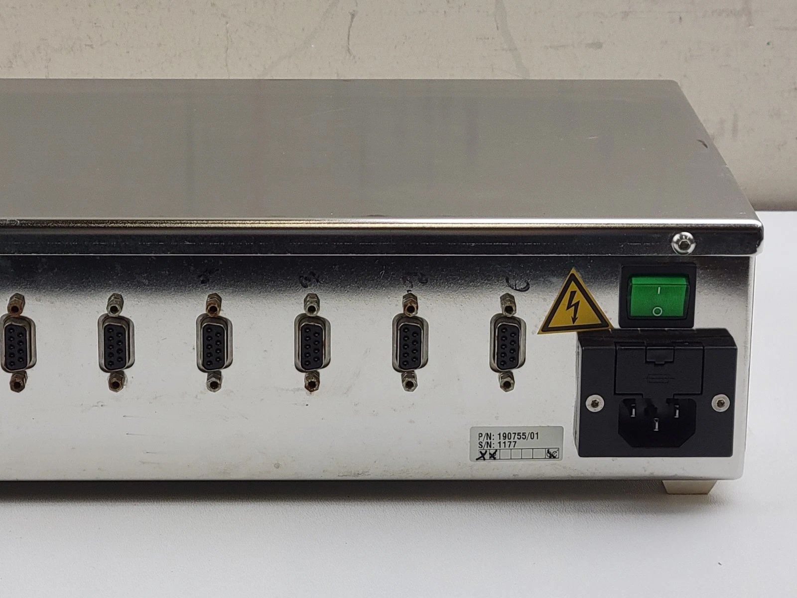

If you aren’t using a hamilton STAR, you need the hamilton heater shaker control box to provide power to the Hamilton Heater Shaker (https://www.ebay.com/itm/137301065214)
Every HHS has a usb type-b port behind a plate on the side and a rotary dip switch behind a plate on the bottom. If you set the rotary switch to ‘0’ and plug it into your computer, the HHS is a ‘master’ and controls all other HHS attached to the same box through the single usb port attached to the master HHS. You can have up to 8 HHS per HSB.

I used HHS box + Hamilton heater shakers as a stand-alone. They’re already supported in PLR so interfacing is not super difficult. If you’re planning to add more shakers in the future it’s a good option but getting a control box for a single device might be an overkill unless it’s significantly cheaper than other options.
