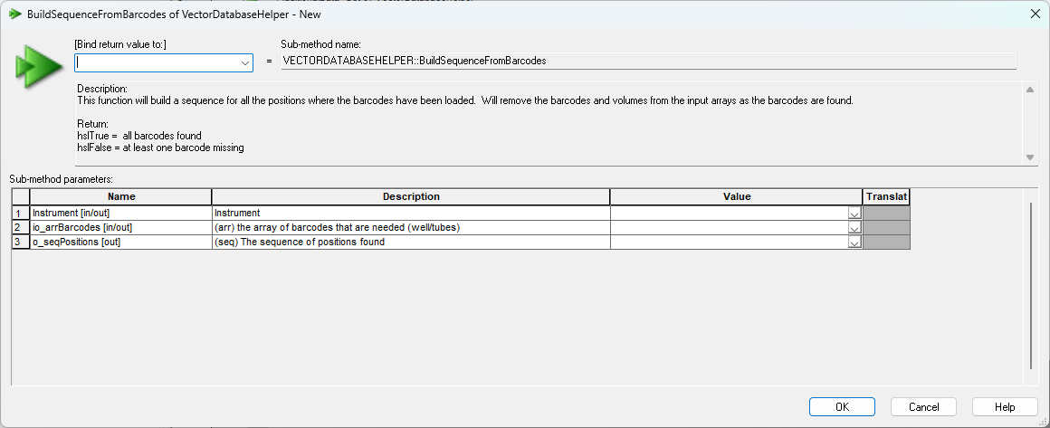

Using Vector Database Helper you can use the BuildSequenceFromBarcodes function to feed an array of barcodes and use the sequence that it outputs.

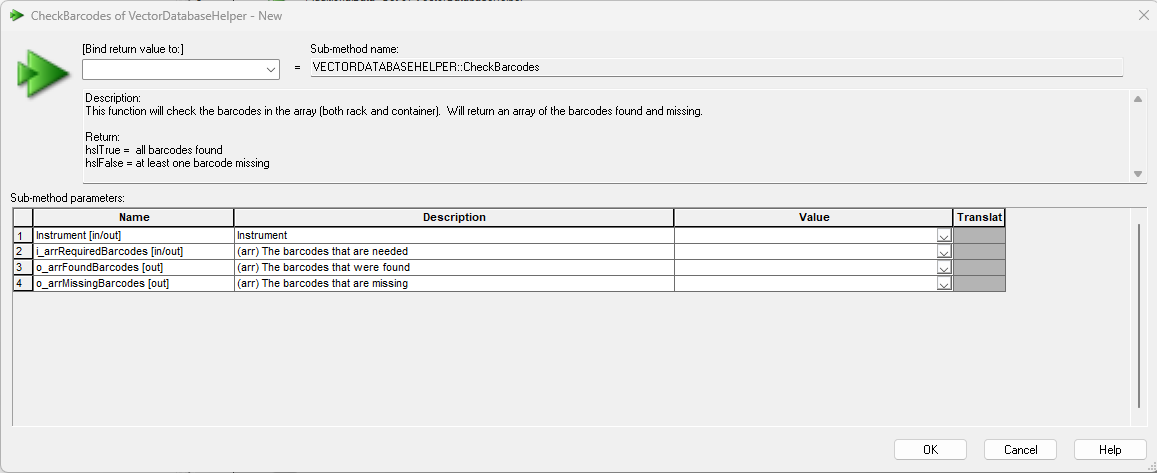

This does require all barcodes to be scanned on the deck which can be verified by using the CheckBarcodes function.

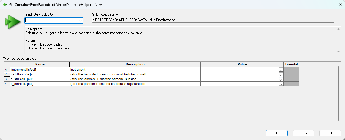

To build the sequence from a worklist to associate source and target positions can use the GetContainerFromBarcode function while reading the worklist that contains both the source and target barcodes. Call this function for each barcode and build the two sequences.

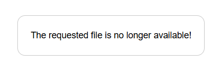

Hello! @BrandonBare_Hamilton could you send the link again please? It has an error…
Hi @Oleksandr ,
The link above is operational again.
