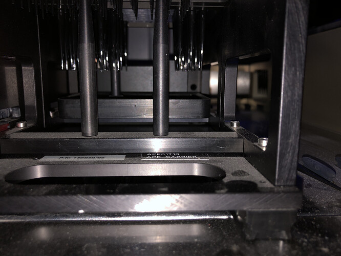

My goal is to pick up a standard tip from a APE_CARRIER/APE 01710 on Hamilton STAR. I tried to just use PLT_CAR_L5AC_A00 like in the docs example but I get an error and the tip gets not really picked up. Generally I am not sure if there is any support for APE_CARRIER/APE 01710. I looked through PyHamilton und PyLabRobot repos but could not find any results for that name.

APE_CARRIER
The error you got means the response sent by the Hamilton was not parseable by PLR. Could you share your log file? It should be located in the directory where you ran your script.
Also, we do not have wrappers for the APE_CARRIER yet. If you have VENUS definitions for those (.rck and .ctr files, likely located in C:\Program Files (x86)\HAMILTON\Labware on a Windows computer with VENUS), feel free to send those over and I can create a wrapper.
I was not able to find APE_CARRIER .rck and .ctr files but will try to get them. I also would need support for SMP_CAR_32_A00 and a self made 3D print construction.
For SMP_CAR_32_A00 I only found the .rck but not .ctr. Do you need .ctr? For the self made 3D print construction I still need to search for .rck and .ctr files. If you share a link to the file where you create a wrapper I could try by myself. Thanks for your offer!

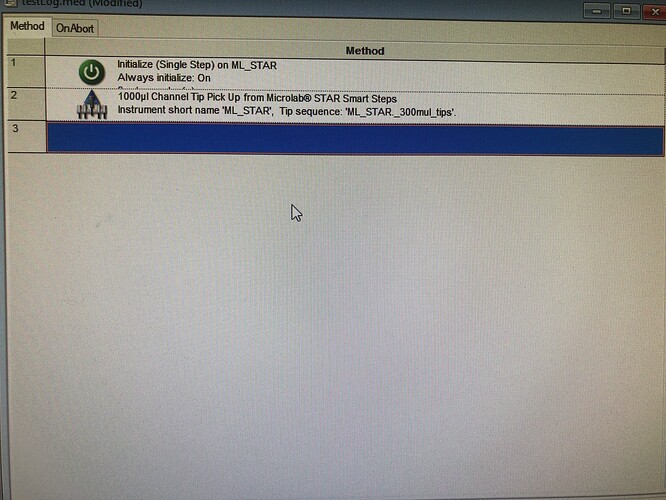

Let’s try to see where, if at any point, we differ from VENUS. Could you try running the same procedure (tip pickup in the same location) in VENUS and send me the log from there? (Should be in C:\Program Files (x86)\HAMILTON\Logs)
The VENUS log files are long so I send them here.
Following a picture of my methods which I used for producing the logs. I am confused because the logs are different compared to them on my Mac which makes it difficult to compare.
